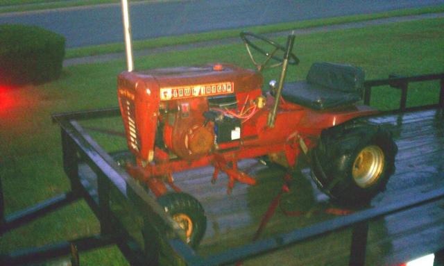

johnscag 7 #1 Posted September 30, 2012 I picked up a Lawn Ranger today, must say i know nothing about the model, but it sure is small!! LOL... Good for garage space i guess!!! Runs 1/2 way decent, little rusty but not to bad, new battery and new rear tires. The electric start is a button though, is this normal? Model 1-2631 Sorry for the bad pics, picked it up after dark and it was raining. 1 Share this post Link to post Share on other sites
Jake Kuhn 1,600 #2 Posted September 30, 2012 Very nice little tractor. It should just have a key switch and no buttons. How about some pics of the dash? ~Jake Share this post Link to post Share on other sites

Terry M-(Moderator) 2,329 #6 Posted October 1, 2012 By the looks of the decals and the model # it looks to be the model year 1968.( I believe) Share this post Link to post Share on other sites
littleredrider 409 #7 Posted October 1, 2012 yeah look like a 68. I had a 67 which is pretty much that same thing. It should have a key to start not a button. I liked mine, motor was tired, then swapped it for a K181. Governor was messed up so wouldn't rev high enough to mow, but with a plow that thing was a mini tank!!!! Even had the same Ags as yours. Great little machines....yours looks good too!! Share this post Link to post Share on other sites

Jake Kuhn 1,600 #9 Posted October 2, 2012 That looks to be how it should be. Thats just a key switch and I'm not seeing a starter button, unless it is somewhere else? Jake Share this post Link to post Share on other sites
johnscag 7 #10 Posted October 2, 2012 That looks to be how it should be. Thats just a key switch and I'm not seeing a starter button, unless it is somewhere else? Jake yes, it is on the left, on top the starter solenoid? right on top in the middle. Share this post Link to post Share on other sites
305 381 #11 Posted October 2, 2012 that solenoid/switch was added , probably because of a bad ignition switch or just to take the load off it. on my lawn ranger i still use the original keyed switch to start , but have added a solenoid under the hood. got it from primeline. as you know the heavy battery cables go through the stock ignition switch , but now mine attach to the solenoid and the switch just activates it Share this post Link to post Share on other sites
