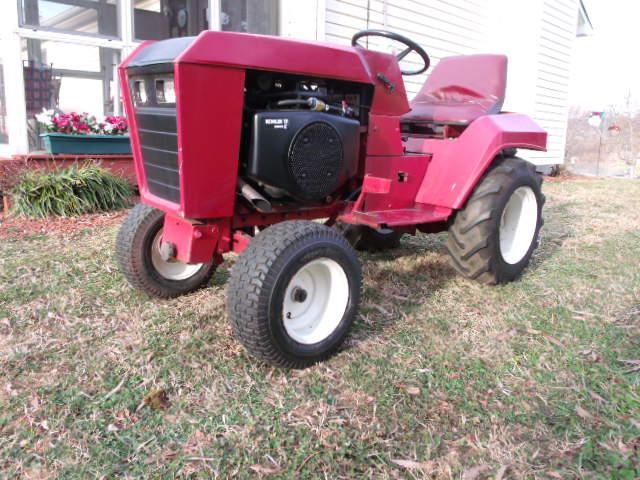

Torino 15 #1 Posted September 20, 2012 What model is this? Share this post Link to post Share on other sites
ol550 850 #2 Posted September 20, 2012 Looks to be a C175? Share this post Link to post Share on other sites
whfan74 2,073 #3 Posted September 20, 2012 I agree with Mike.......slap some decals on there and it will do it wonders! Share this post Link to post Share on other sites
SousaKerry 503 #4 Posted September 20, 2012 Not only is it a C-175 it features a Series II KT-17, Much better engine then the original. I have the same engine in mine and it is a beast. Very capable machine. If indeed it started out life as a C-175 it would have had the series I KT-17 motor, which was a problem child to say the least from Kohler most wound up throwing rods due to a poor lubrication system. Check under the dash for an aluminum tag with the model and serial numbers, if there we can tell you what it started out as. The picture in my profile is my machine before the engine upgrade. The center of the hood (depressed section) should be black hence the name for the series "Black Hood" Share this post Link to post Share on other sites

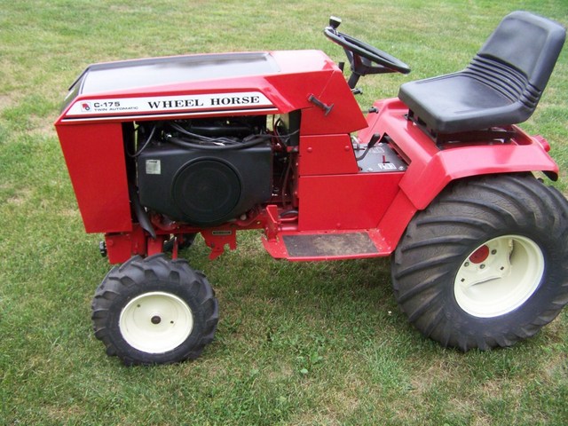

JackC 618 #5 Posted September 20, 2012 Maybe 1980 or 1981 C-175 Black Hood based on the hydro lift lever and the level indicator on the side cover above the foot rest. Has the newer Kohler Series II engine unless someone just put the Series II fly wheel cover on the original Series I. The plastic fender appears to be in good shape. Many replace it with the metal fender. Those are great machines. I have 4 of them. This is one of them: Share this post Link to post Share on other sites
Jake Kuhn 1,599 #6 Posted September 20, 2012 yep, looks like a c175. Looks to be a very nice tractor! ~Jake Share this post Link to post Share on other sites
Zeek 2,299 #7 Posted September 21, 2012 I do NOT like like half-a$$ spray bombers . . . . Sorry personal pet peeeeeeve . . . Share this post Link to post Share on other sites
AMC RULES 37,256 #8 Posted September 21, 2012 I surely wouldn't kick one of those "bombers" out of the barn. Share this post Link to post Share on other sites
boovuc 1,090 #9 Posted September 22, 2012 I love my C-175. Even with the Series I engine. The most perfect powered tractor I own and yes, I have a 416-8 and a 520-H. I've owned mine for decades now. I really think the C-175 was one of the 5 best tractors Wheelhorse ever made. I would say the C-160 is right up there with a few other larger single kohlers. I would love to have a Series II KT Kohler in a box as a replacement in case mine bites the dust some day. I know some folks never liked the style of the Blackhoods but they grow on you after awhile. Share this post Link to post Share on other sites
bowtiebutler956 650 #10 Posted September 22, 2012 Looks like it still has a very nice body on it! Even the rear fender looks to be in great shape. Matt :flags-texas: Share this post Link to post Share on other sites

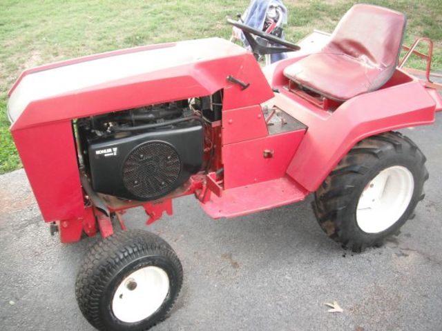

Torino 15 #11 Posted October 12, 2012 Finally got it. Started out wanting 650 with a turning plow and a rear after market blade. I already have those. Listed today for 350 without plow and rear blade. Went buy he and had a hard time starting it. I think he flooded it. Got it to run. Runs great with no smoke but you have to give it a little choke to run smooth. So, I hoped it was not anything major and gave him 300. He said it has been sitting alot and it did run great. I have dealt with him before and believe he is honest. Did get the clevis hitch, extra mule drive and pretty sad looking 30 something inch deck also. The rear deck is in great shape. I downloaded all the manual I could from Toro, is there a place I can download a owners manual? It is a 1980 C-175. Share this post Link to post Share on other sites

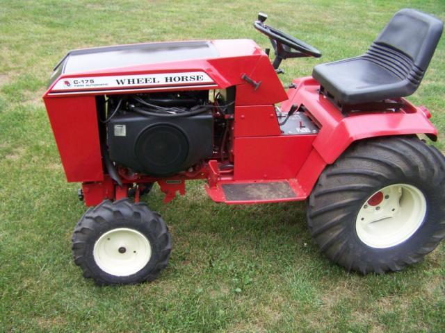

546cowboy 302 #12 Posted October 12, 2012 Here is a C-175 I have. It has the steel seat pan and the tires are too big but I have a set of smaller ags that I haven't got around to changing yet. Share this post Link to post Share on other sites

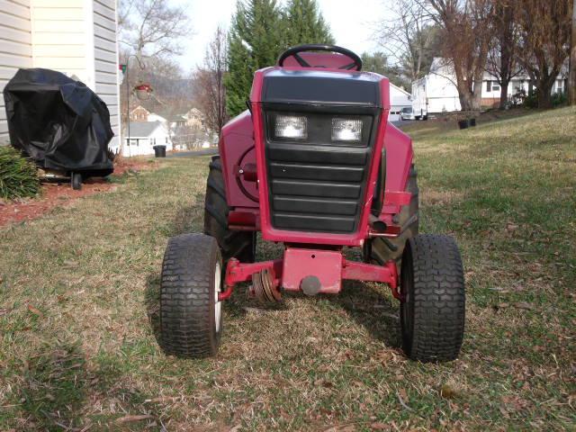

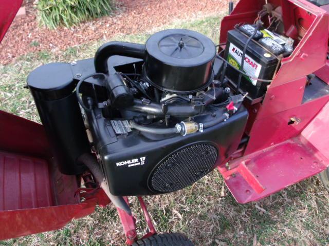

Torino 15 #14 Posted March 2, 2013 I forgot to finish this thread. I took the carb off and cleaned it and it runs great now. 1 Share this post Link to post Share on other sites
boovuc 1,090 #15 Posted March 2, 2013 NICE! Very nice restore! Share this post Link to post Share on other sites
leeave96 496 #16 Posted March 2, 2013 I'd say you got a pretty good deal. One thing you should do if you ever rid yourself of the tractor is keep the sleeve hitch as they are a pricy item these days. Share this post Link to post Share on other sites
stevebo-(Moderator) 8,609 #17 Posted March 2, 2013 I see the sticker on the engine says series II but has that been confirmed? Looks like the tins are a series I. Share this post Link to post Share on other sites
Torino 15 #18 Posted March 3, 2013 According to the spec and sn it is a series 2. But they are both stickers so I guess it would be easy to fake. How would I go about making sure it is a series 2? Share this post Link to post Share on other sites
boovuc 1,090 #19 Posted March 3, 2013 They made the Series II's with the old engine cowling for years. I don't doubt you have a Series II engine. The Series II has a full pressure lubrication system. (No oil filter). If you look under the PTO you may be able to see on the bottom of the engine a little square housing that holds the oil pump. Just to the side of the engine on the PTO side, you may be able to see a small 1/16" NPTF plug that can be used to read oil pressure. (Up to 50 lbs I believe). It may not be very visible and there are very few differences between the Series I and II without tearing of the tins and engine. Share this post Link to post Share on other sites
JackC 618 #20 Posted March 3, 2013 The Series II has a port cover for an oil filter and nearby is a port for an oil pressure gauge on the rear half of the crankcase on the PTO side of the engine. For the wheel horse application there is probably not enough room for an oil filter directly on the engine but a remote filter can be used. The Series I does not have that. The Series II was developed by Kohler to overcome the oiling problems with the Series I when it was run on inclines. The Series I oiling is OK as long as not run on inclines. Share this post Link to post Share on other sites
SousaKerry 503 #21 Posted March 3, 2013 My series II has the oil filter on the block fits fine no problems. And my oil pressure gauge will peg out at 80psi even when cranking. Once warmed up usually runs around 60 Share this post Link to post Share on other sites
