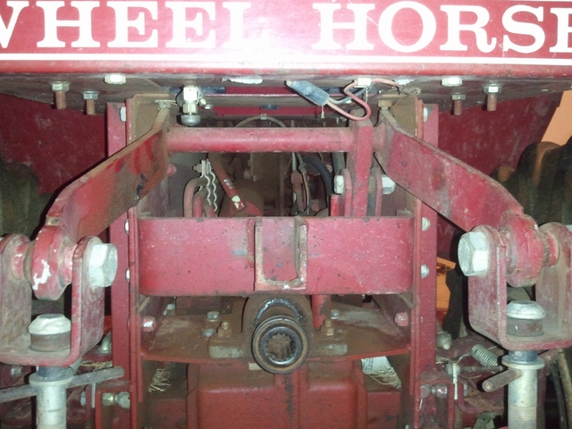

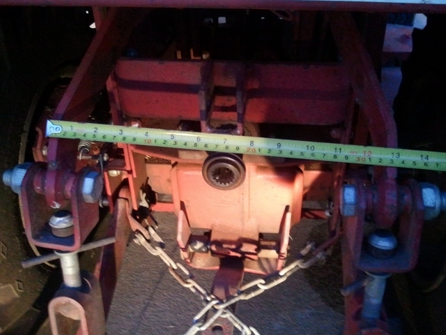

JackC 619 #11 Posted September 27, 2012 denny, can you do me a favor and measure the distance between the two top lift arms of the three point hitch? The measurement should be about 20 inches from the center to center at the outer points of the two top lift arms. Mine are bent inward and I want to be sure of the distance when I have then bent back outwards. I have not heard of any valve seat problems with the ONAN BF-MS engine. I have heard of problems with the newer P series. The way the engine is mounted on the D-160 there should be no cooling problems and the fly wheel fan provides plenty of moving air over the head fins when the engine tins are all installed. The way the P series is mounted in wheel horse tractors (416 and 520 for example) , the back cylinder is in a tight spot and may overheat. Thanks My bent upper lift arms: Share this post Link to post Share on other sites
dennyandcarrie 9 #12 Posted September 27, 2012 I will try to get out there tonight and measure them. Share this post Link to post Share on other sites

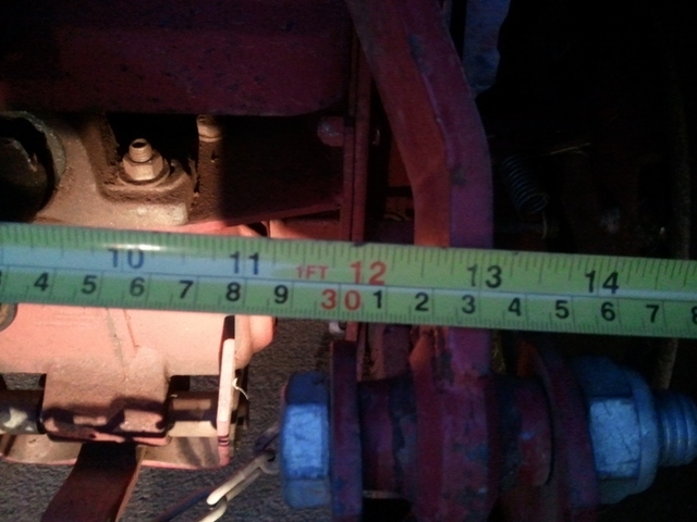

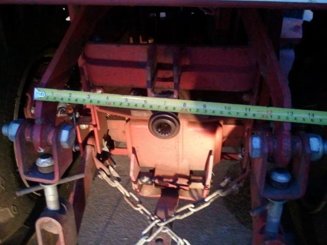

dennyandcarrie 9 #13 Posted September 28, 2012 I have attached a couple of pictures. I measured from outside of one bar to outside of the other. It measures 13 1/8 inches. Share this post Link to post Share on other sites
Trouty56 568 #14 Posted September 28, 2012 I got 13 inches from outside to outside of the bars..... Oops....too late.....lol Share this post Link to post Share on other sites
dennyandcarrie 9 #15 Posted September 28, 2012 Here is another picture to help you see how it was originally bent. Share this post Link to post Share on other sites
JackC 619 #16 Posted September 28, 2012 Great, thanks to both to confirm the 13 inch spread. The pictures help too. Good thing I did not go with 20 inches. Since these are category 0 hitches I believe it must be the lower arms that should be able to spread to 20 inches. Now I need to find a fabricating shop to bend mine back the way they should be. It looks like they may need to unweld the arms from the shaft, then bend the arms the way they should be maybe with some heat, and then weld them back onto the shaft. Share this post Link to post Share on other sites

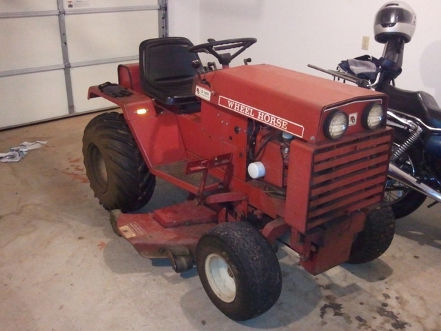

JackC 619 #18 Posted September 28, 2012 Denny, your hitch looks pretty clean. When you get a chance let us see some pics of the machine. Here are some pictures of one of my 1977s. I have two. Share this post Link to post Share on other sites
dennyandcarrie 9 #19 Posted September 28, 2012 Wow!! I am not sure how those got bent like that. It would take some serious pulling or impact to bend them like that. Yes my tractor is in excellent condition. I am wanting to clean it up really good this fall and winter. I will post some pictures sometime. Share this post Link to post Share on other sites

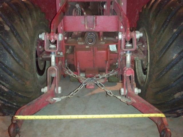

dennyandcarrie 9 #20 Posted September 28, 2012 It looks from the picture that someone has heated it up and bent the arms straight up at the top where the arms are welded to the shaft. As you can see on mine it comes straight off of the shaft about 2 inches then bends out at an angle then at the connection point at the end it straightens back out. Not sure if the arms will have to be unwelded from the shaft but I think you will definitely need some heat to bend it back correctly. The bottom part of the hitch can spread out over 20 inches wide but in the picture you can see that the criss crossed chains hold it in place. Mine is at around 21 inches right now. Share this post Link to post Share on other sites
JackC 619 #21 Posted September 28, 2012 Thanks for the pictures. They will help me get mine back to spec. The lift arms are intended for lifting not pulling. It appears that someone tried to pull something perhaps with ropes tied directly to the upper lift arms. One of the lift arms is even twisted. The steel used in the hitch likely does not have a lot of temper so that they will give or bend before they break. Your D-160 looks like a nice original that was well taken care of. It looks like all it needs is a little cleaning and polishing to give the finish some shine. I like to keep things as original as possible including the finish. If your steering is loose, like on most, there are two adjustments at the bottom of the Ross steering shaft to tighten it up. You may want to do a compression test to check the overall health of the engine. That engine will still run fine with a fair amount of wear and low compression. I think between 110 and 120 is where the compression should be for a new engine or one with little wear. There should be less than 10% difference between the two cylinders. There is a service and parts manual for it that will tell you about all you need to know. Good luck with it. Share this post Link to post Share on other sites
