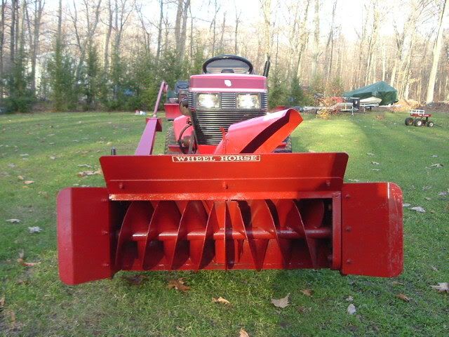

HorseFixer 2,015 #14 Posted September 17, 2012 The wings are on the wrong sides. which of them Both of them, flip them both over 180 deg. And the instead of the outer edge flaring out then they will be straight like this one. By the way nice blower! http://i219.photobuc...6/Nelson255.jpg Share this post Link to post Share on other sites
Lars 526 #15 Posted September 17, 2012 The wings are on the wrong sides. which of them Both of them, flip them both over 180 deg. And the instead of the outer edge flaring out then they will be straight like this one. By the way nice blower! http://i219.photobuc...6/Nelson255.jpg The blower was like this when i got it.. i have turned them around now.. Thanks guys.. Just hope it works great too. Share this post Link to post Share on other sites

Wyattrrp 59 #20 Posted September 21, 2012 Nice Blower Lars You will appreciate how the tall chute throws. The wings are there to extend the 36 inch auger width, to pull in snow 3" extra on each side for a width of 42 inches, thus it is called a 42 inch single stage thrower. In the files section there is a manual I posted that is pretty much the same as your unit. In that manual you can see the wings are to angle out but the last bend is to face forward to cut a line in the snow not plow it as they would in your original configuration. Also note that the Vee wire in front of the chute is to prevent you from sticking a hand into the chute to unclog set heavy snow while the auger is rotating. It shouldnt be moving as the PTO safety switch will shut the tractor off when not seated but as a caution in case you by passed that PTO switch they put in the wire. Note that in fluffy snow with a light wind and the chute facing forward or slightly turned the auger throws some snow lout forward missing the top of chute through that wire area guard and it comes back on the driver. I posted a video last January which shows that blowback of upward snow that passes the wire guard. Later models of the single, as well as 2 stage blowers, have an 8 inch metal chute cover in front of the opening where the wire is shown in your photos. The snow that might travel out the front through the wire guard hits the solid cover in front, thus redirecting that 10% of the snow upward to the top of chute where it joins the main snow flow and reduces the blowback. That is why they added the front cover in later models. Not the end of the world but if no cab but it does make for more blow back onto the driver. Here is a link to theposting asking about the cover and what it would impact then the dimensions to build a cover. The factory covers bolt on by using the tall chute bolts at the bottom near the gear ring. Mine uses the wire guard holes with wing nut bolts so it is easy to remove before a storm if the snow is wet so it will be easier to unclog if a slushy snow is to be blowed. The blowback is only from fluffy snow. Here is the link. . About half way through the posting I have a diagram with dimensions to the right of the photo and if you click the diagram it will enlarge so you can print it full size. Cost was $7 for a piece of sheet metal large enough to make 2 covers and Toro I think has them for $50 EA. The cover did help last winter for the small fluffy January storm we finally had in the NE. Now lets hope for enough snow to have to actually use a blower this year Wyatt BTW I have 2 extra high chute blowers that came with tractors I have bought in the past and will put both up for sale next month. They are in nice shape with tight chains and sprokets and come with lift rods and flags. Just need to dig them out of the back of the barn when I get time. Also have a 48" plow w/ rear bracket for sale next month. 1 Share this post Link to post Share on other sites
