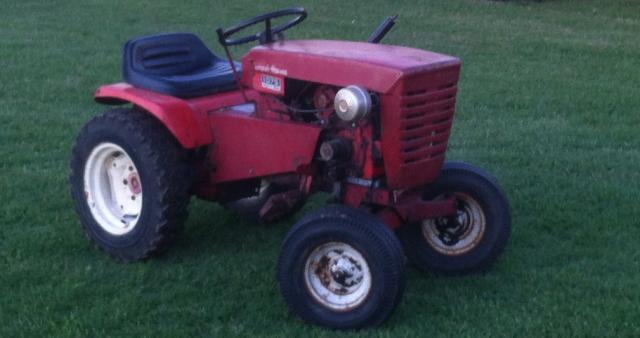

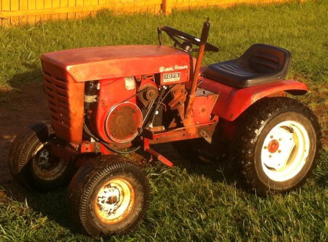

Ken B 3,203 #22 Posted September 13, 2012 So, where are the pics? Share this post Link to post Share on other sites
MR49 20 #23 Posted September 13, 2012 Here is the only ones it would let me put on here. The other ones were to big. Share this post Link to post Share on other sites
546cowboy 302 #24 Posted September 13, 2012 You are one lucky new owner. Any running Wheel Horse for $80 is a steal!!! That is a good looking horse and unless you plan on a show tractor it will be a great worker. With deals like that the addiction will only get worse. :laughing-rofl: Share this post Link to post Share on other sites
Zeek 2,299 #25 Posted September 13, 2012 I would say you got an excellent deal for $80, it looks like it's in good shape! Share this post Link to post Share on other sites
