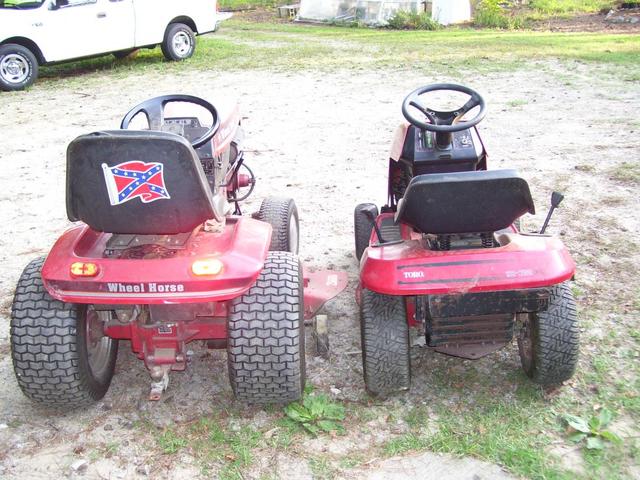

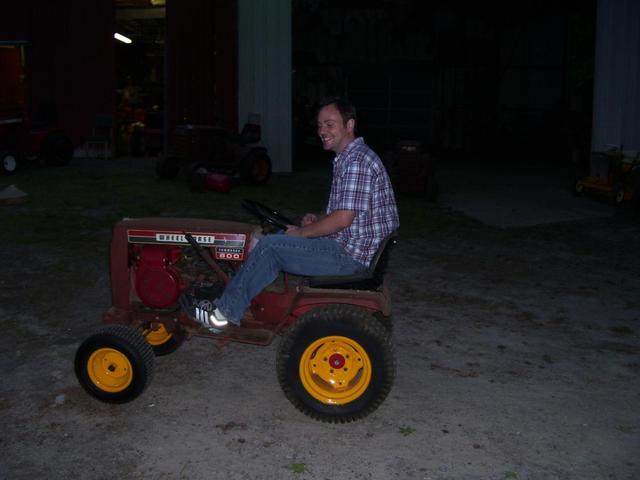

jay in nc 210 #17 Posted September 16, 2012 this is my commando 800 with big boy shoes. 8-850 on front , 23-9.50-12 sears script carliles on the rear. am going to put this same size tires on the 310-8 . just change the hubs on the commando to make the switch Jay Share this post Link to post Share on other sites
njdpo 10 #18 Posted September 17, 2012 Hi Jay - thanks for the reply. Regarding : just change the hubs on the commando to make the switch... Not being entirely sure about what you were walking about (change the hubs) I took a look at a unidrive repair manual. And I see the axles coming out from the unidrive with keyways... So I guess these rims / hub combos are not universal across the unidrive lineup then? ... bummer ... Do axle diameters factor into purchase of the correct hubs too ? (in other words - would the hubs from a 310-8 fit onto my Commando's 3 speed unidrive axles ? ) All it takes is money... That combo looks like a great setup for my fire wood fetching machine... (short wheel base, tight turning capabilities for the trails in my back yard, and great clearance for the rocky terrain...) Jay - have you had any problems hanging a mower deck from the machine ? I'd like to be able to keep the 36 RD operational for my young son to mow the lawn for me - I think the 310-8 is gonna be too big for him. - Thx Dave Share this post Link to post Share on other sites
jay in nc 210 #19 Posted September 18, 2012 ok when i said to change the hubs to make the switch it is because the center hole is larger on the 12 in. rims than the 10 in. rims. the bolt pattern is the same, you can bolt the 12 in wheels to the commando 800 to try the mower deck, BUT all the weight & torque of the tractor will be supported by just the 5 lug bolts. you will need the support of the correct hubs. kelly or j-dog or some other venders will have 1 in hubs reasonable. my commando 800 is one of my favorite work tractors it turns quickly, goes faster sips gas & is great pulling the lawn sweeper. the front wheels on my commando are off a large 20 hp yardman gardentractor & they are bushed not bearing equiped.I will take pictures this weekend with a yardstick agenst the rear fender of the 310-8 wearing 22x7.50-12 rear tires then 23x8.50-12 rear tires then 23x9.50-12 rear tires all with 12p.s.i. so that every one can see the difference between the sizes. good luck with your tractors Jay Share this post Link to post Share on other sites

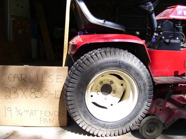

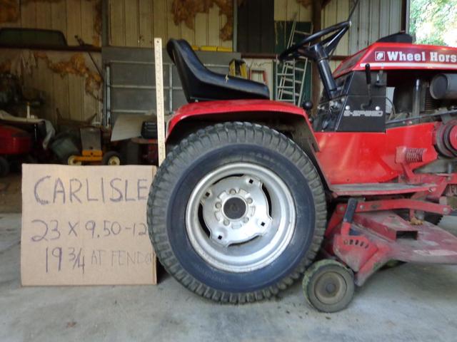

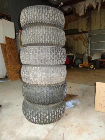

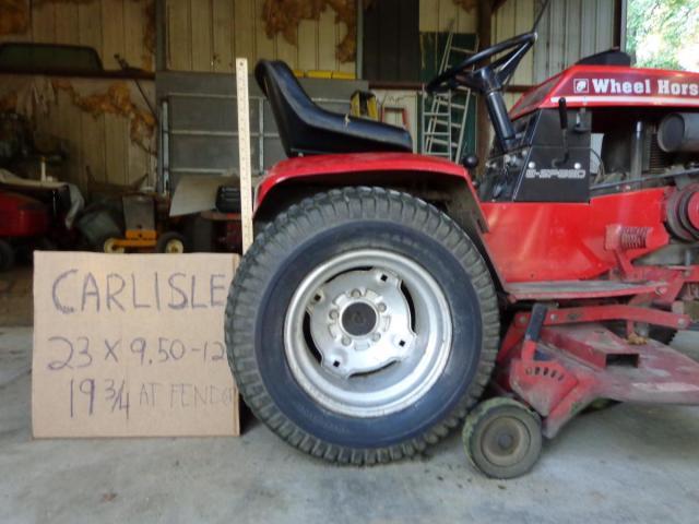

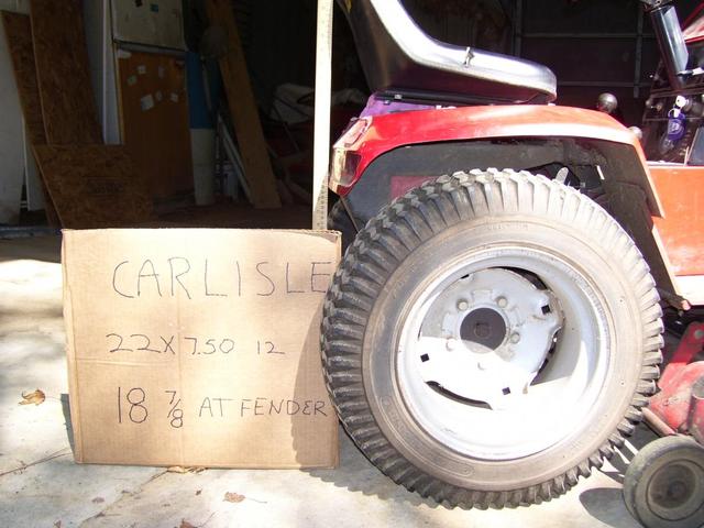

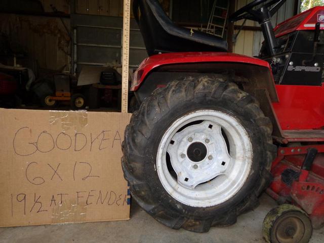

jay in nc 210 #20 Posted September 22, 2012 as promised i tried 4 sets of tifes on the 310 -8 today. i also put a yardstick in the center of the fenderpan & measured the height . the tires were carlisle 22 x 7.50 -12 these were on the tractor when purchaced carlisle 23 x 8.50 -12 carlisle 23 x 9.50 -12 & last but not least a sat of 6 x 12 goodyear trator lugs off of my rj-59 , they look funny but i left them on it to see if they made a difference on the side ditch bank and last the stack of tires biggest on the bottom, smallest on top. i also did not try the 23 x 10.50 - 12 tires because i don't think they will clear the guage wheels on the 42 in. sd deck but here are pictures of them on my 518 518 on the left 12-32 on the right. hope this clears up some things or raises more questions L.O.L. Jay 2 Share this post Link to post Share on other sites

jay in nc 210 #22 Posted September 23, 2012 one of the reasons i tried the different size tires on the 310-8 IS ground speed. i normaly only mow with hydro tractors the exception being my raider 12 that i use in the goat pasture. the 310 seems to go too fast in 3rd gear to give a nice cut, but drives too slow in 2nd . i figgured the 23 - 9.50 12 would speed it up enough to mow in second gear. but there isn't much difference. i dont mow with the commando 800 but there was a big jump in speed going from the 10in. tires to the 23 x 9.50-12 set. my back tractor shed is 250 yards or more from the main shop & it's the fastest horse in the stable. so that gets a lot of cart pulling duty. i just got new blades for the1968 commando 8 & will be giving that a chance ,but with a 36in cut it won't be mowing much. i'll try some 4-3 speed tractors back to back with some 6-8 speed tractors & let everyone know the seat of the pants differences. Jay Share this post Link to post Share on other sites
