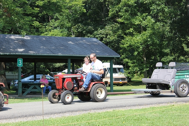

steve k 82 #1 Posted September 6, 2012 Hello, I am new here but this is a great forum!! I inhereted my Grandfathers '69 electro 12, which worked great for years. Eventually reverse got slower and slower . I found a pdf file on this site for trouble shooting and repair of the sundstrand hydro gear. I followed the procedure and found the springs in the reverse valve trashed. The ones for the forward valve only had a couple coils broken off....... Does anyone know of a source for these springs? Thanks! Steve 1 Share this post Link to post Share on other sites

AMC RULES 37,260 #3 Posted September 6, 2012 Cool sulky for two Steve. Share this post Link to post Share on other sites

steve k 82 #5 Posted September 6, 2012 Yeah, that sulky is awesome. Actually three people fit on it, its the rear seat out of a caravan! Thanks refracman! Share this post Link to post Share on other sites
