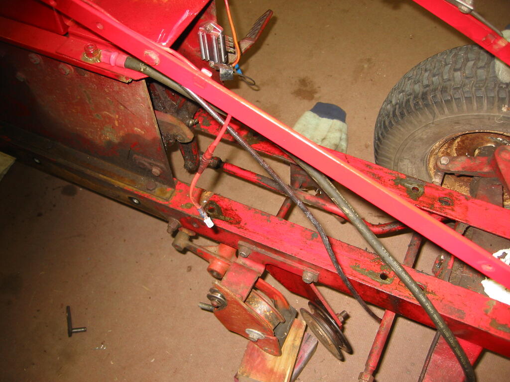

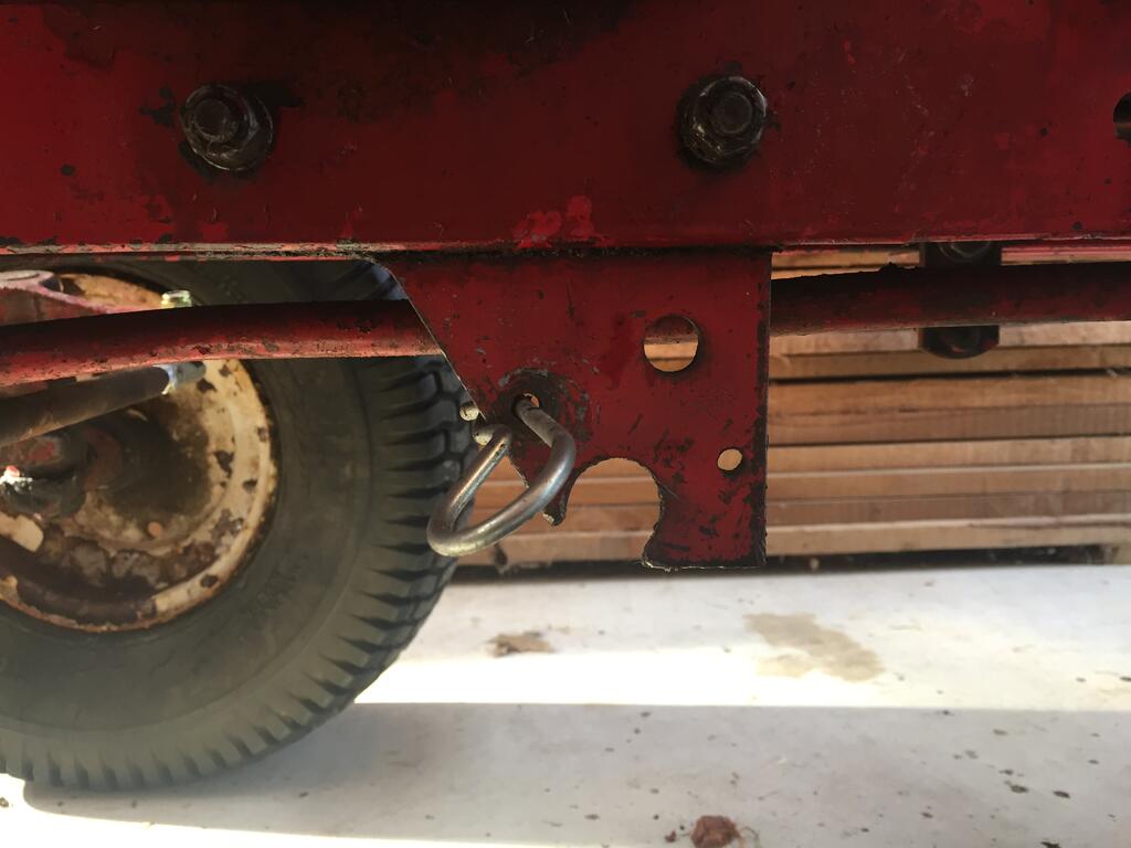

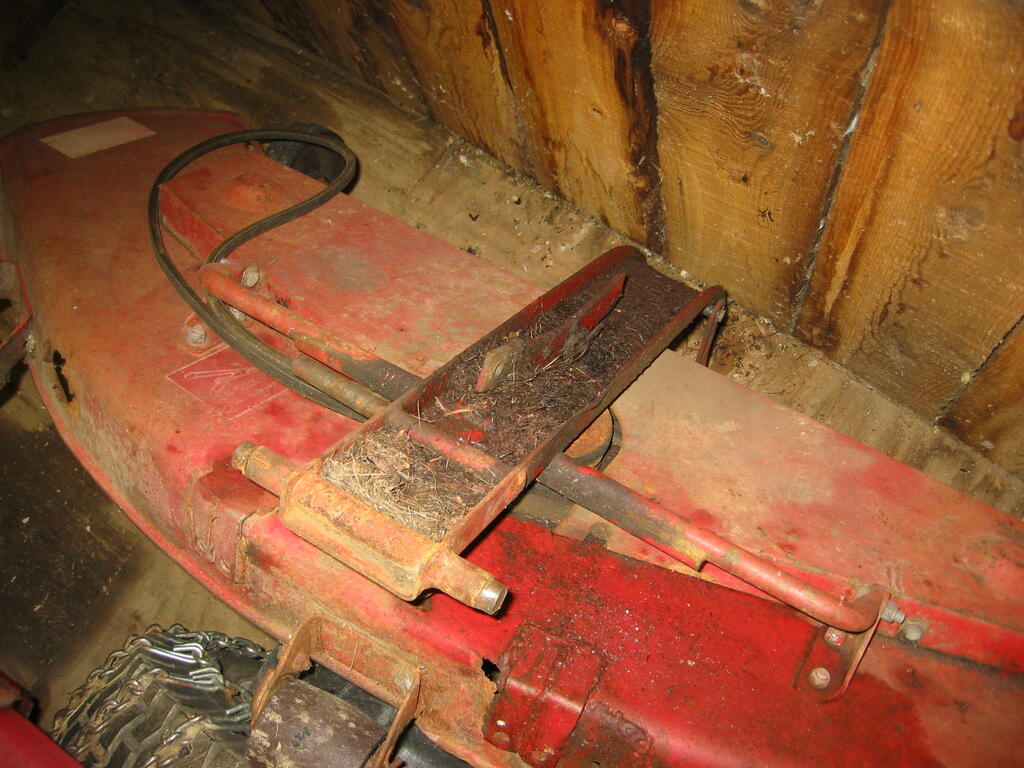

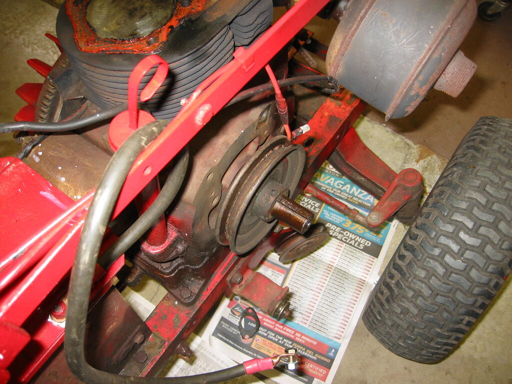

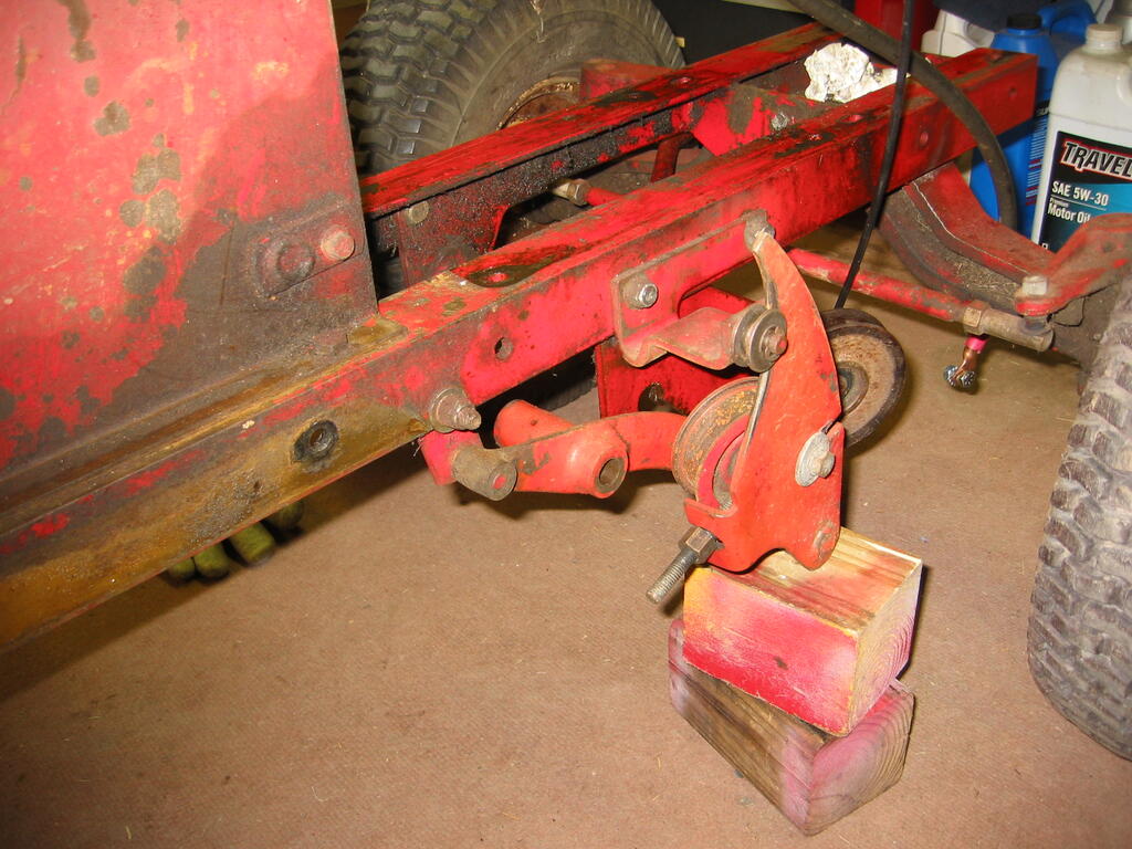

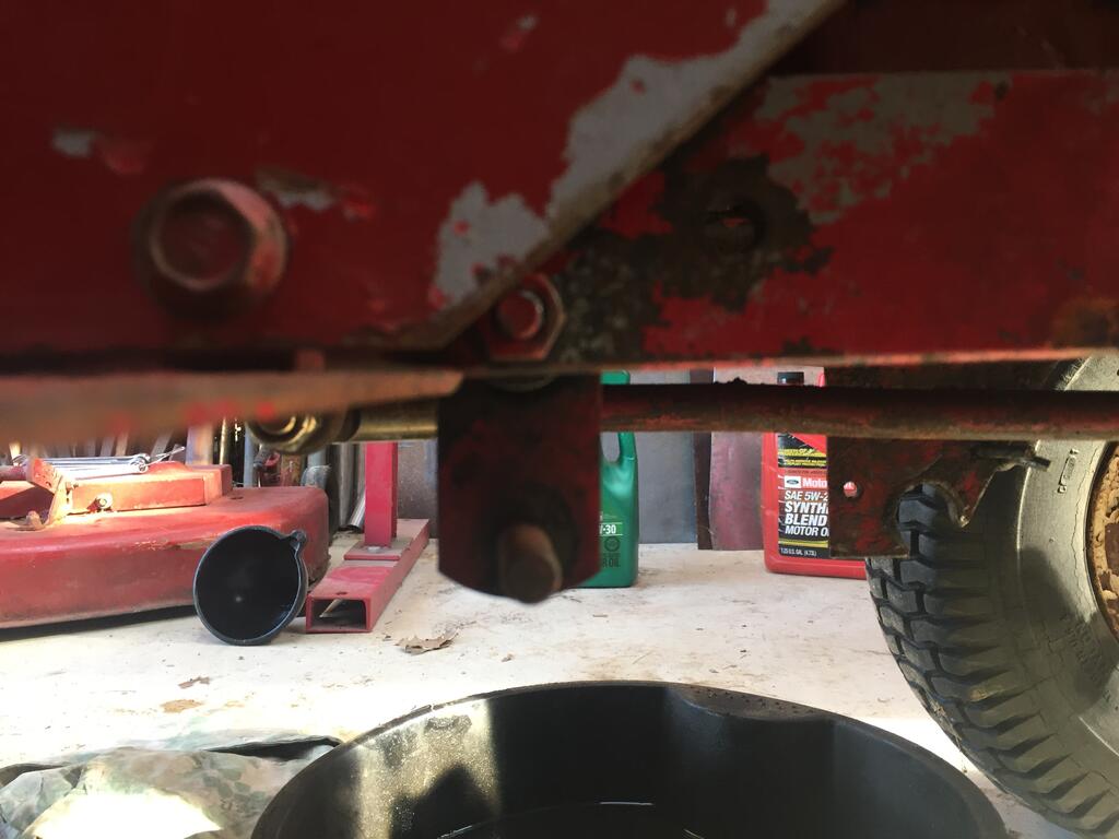

JimSraj 577 #6 Posted June 10, 2021 I realize this post is nearly 10 yrs. old but I’m gonna give it a go anyway. I recently got a 1969 GT14 (1-7441) as well as the mower deck for it. The deck is not on the tractor and I think there are some parts missing in the lift arrangement. No lift rod and looks like only One side of the front mounting bracket is on the Tractor. No latching mechanism either. Any help with what this should be will be greatly appreciated. Here are some pics of what is on the Tractor. As you can see only One side has the front bracket that accepts the deck and I don’t see how it would stay in place. Is something missing? Dave Oman was good enough to furnish blowup of the deck. Anyone know where I can get info (pictures) of what should be on the Tractor? Thanks in advance. Jim Share this post Link to post Share on other sites
