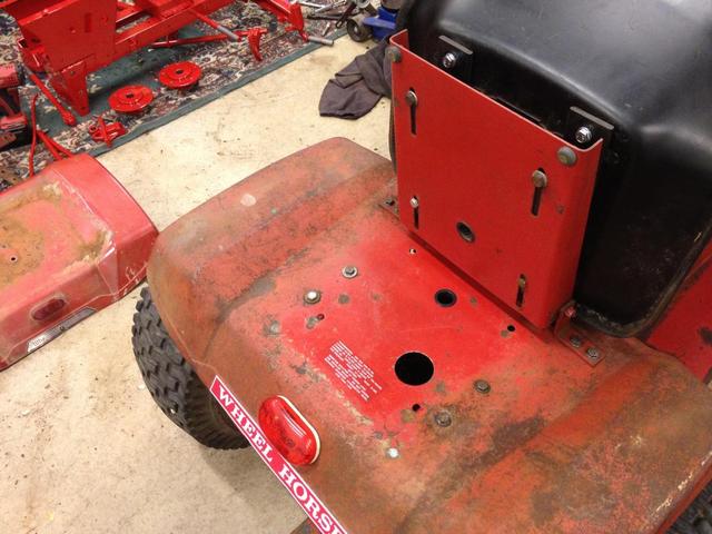

Martin 2,134 #12 Posted September 7, 2012 jack, yes i seen that thread the other day. thanks.... just as an experiment, i went out after my last post here and messed around with the levels. i even checked the dipstick level against the sundstrand in the 875. the c160 dipstick is short and is hard to get to and i always wondered if it wasnt correct for this tractor. the levels are exactly the same as the old square plug dipstick on the 875. i didnt check it against the 1277, but i think that both the 875 and 1277 are the same so i didnt bother. anyway the levels are all the same, should be slightly above the axle tubes (rough description)... on your c160 what does your dipstick look like? is it short enough that you cant reach it through the dipstick access hole in the seat pan? looks like the dipstick on mine should be for the tilt up seat pan instead of the fixed. maybe the 75 has the tilt up. mine is a 76 and is fixed with the seat only tilting up on the fixed seat pan. maybe they carried the short dipstick over for a bit onto the 76 setup... anyway i topped up the level a little to get it dead on full. running or stopped the level stays the same on mine....... it didnt make any difference to my problem. the thorough warm up the other day seems to be the only way i could stop the problem..(only happened once though) like you, at the moment i am leaning towards valves (sticky not broken springs) as being the culprit for my problems... theres an orifice in the accel valve that i need to look at too..... i dont want to tear into this one yet as i have another tractor for my son to start on, so it will wait until i have some spare time...... 1 Share this post Link to post Share on other sites

JackC 619 #16 Posted September 11, 2012 Martin, my 1975 has the tilt back seat. The stick is very easy to get to. The stick itself is only 51/2 inches long. Share this post Link to post Share on other sites
Martin 2,134 #17 Posted September 12, 2012 that looks like the same dipstick length as mine jack. i dont have the toolbox etc just a bracket that sits on the top of the trans that the seat pan bolts to.. makes it a little challenging to reach through the hole in the seat pan, much easier to get it from underneath.... Share this post Link to post Share on other sites
