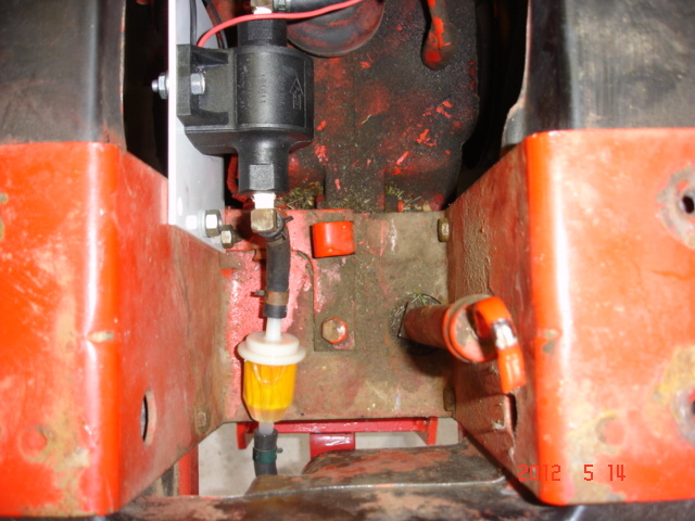

SousaKerry 503 #2 Posted August 22, 2012 You can always go electric as I did Mr. Gasket makes a nice low pressure model 2-4psi available in most better automotive stores for $40 or less. http://www.amazon.com/dp/B000BWCERY/?tag=hyprod-20&hvadid=15469435059&hvpos=1o4&hvexid=&hvnetw=g&hvrand=18106121571727600971&hvpone=&hvptwo=&hvqmt=&ref=asc_df_B000BWCERY Share this post Link to post Share on other sites
