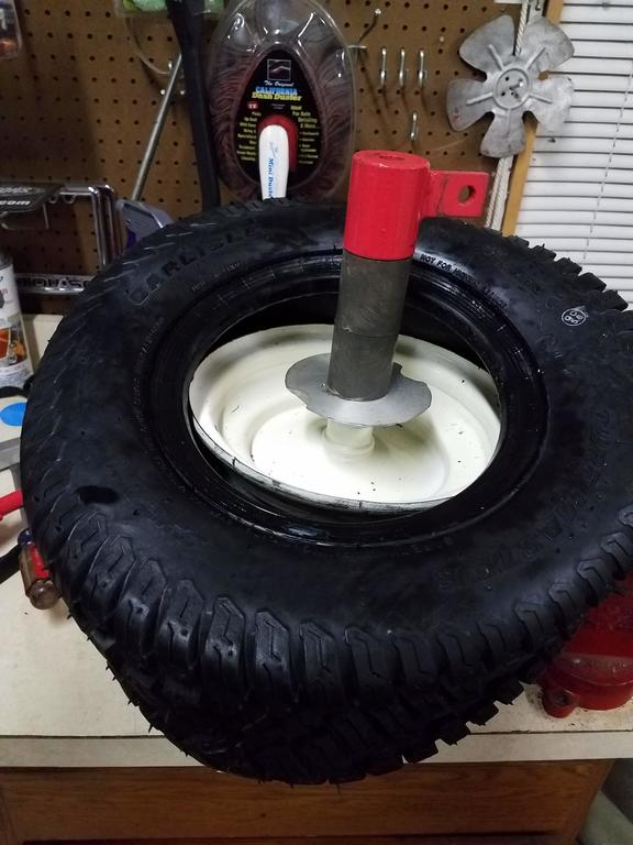

RandyLittrell 3,944 #31 Posted May 29, 2019 I know this is old, but I finally bought one this last weekend and it works really well! I just clamped in the vise instead of bolting it down. I worked at the coop in high school and sometimes helped at the service station so changing tires is a little old hat, but its the best 33 bucks I have spent lately! Randy Share this post Link to post Share on other sites
