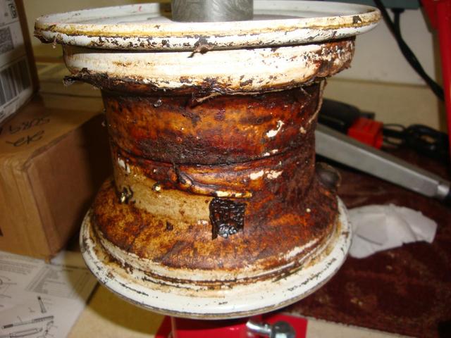

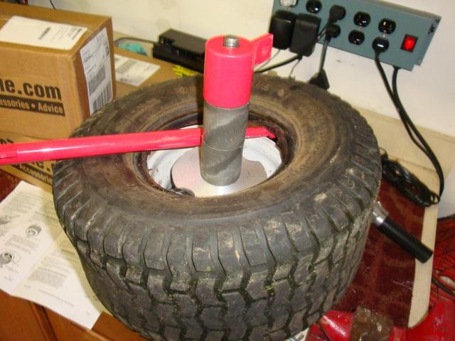

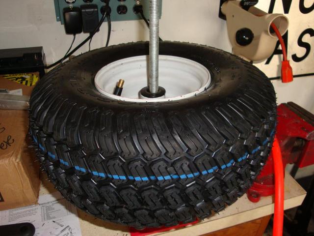

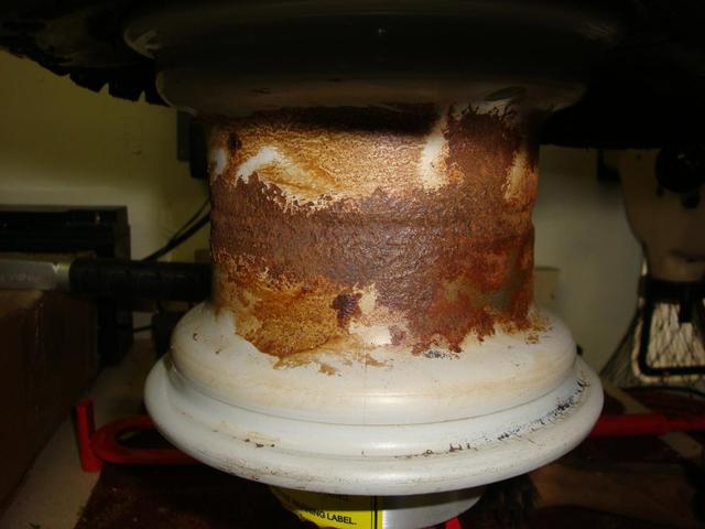

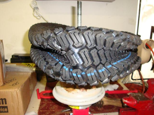

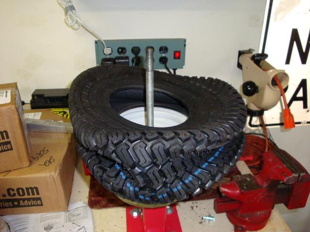

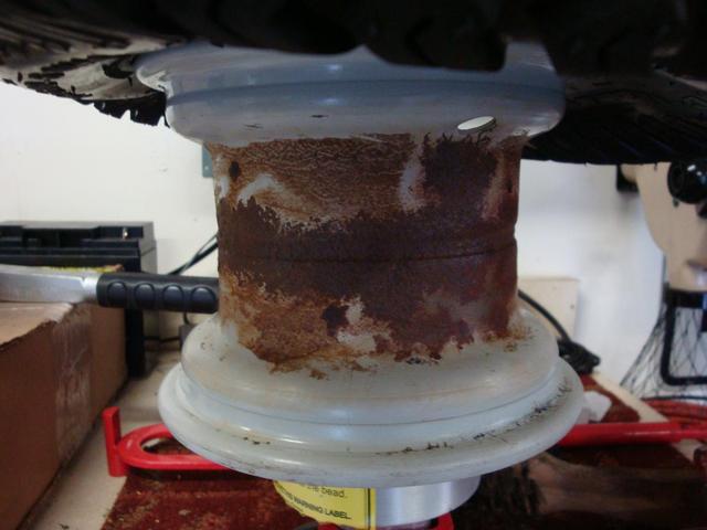

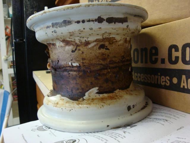

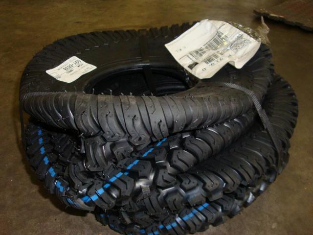

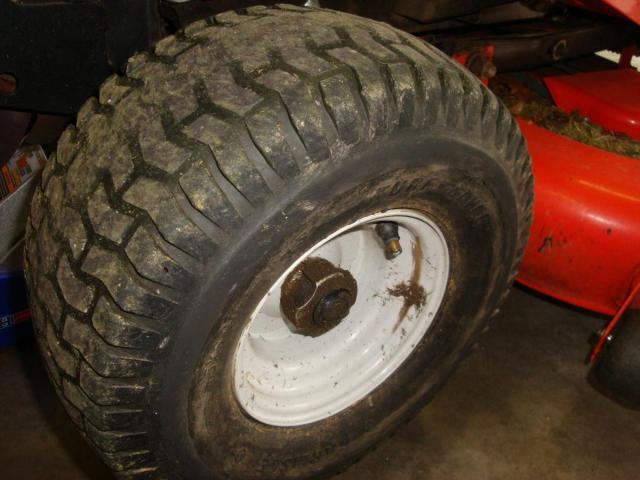

Zeek 2,286 #1 Posted August 17, 2012 I have a bunch of tires I need to mount, etc. so I thought I would spring for one of these mini tire changers at HF http://www.harborfre...nger-34552.html I know you can use screwdrivers, pry bars, hammers or whatever, but I got this on sale for $33 with coupon so I thought what the heck . . . I'm a tool guy. Started out with these two front tires on my lawn non-WH tractor. They both had leaks and needed filled every few days. If I have to go to the work of dismounting, I'm not screwing with a tubes when the tire itself is worn out anyway. Dismounting was a breeze and both tires were off no time flat Bead breaker works great. I mounted the whole thing on a bench and the top of the mounter is removable. Fix-A-Flat worked good for a year or two, but I would not recommend it because it gums up your rims and is a pain to clean off. I got these tires from eTires.com for $15 each. It's a non-WH turf only tractor, so durability/quality/etc were not a concern. Their shipping method is very simple, which I guess offsets the cost. The down side is they are hard to get re-spread for the bead to seat. At first I thought this would work good after watching YouTube videos (straps didn't do anything - Maybe if the tire was in a regular shape) MOV06359.MPG Maybe I needed more starting fluid or more ball$ (or perhaps God did not want me to die in a furious garage fire at the tender age of 47 before Olde Tyme Days) . . . so I decided to give them a bug hug while pushing air in with the valve stem core removed and eventually got them seated. After researching several forums I found that 303 Protectant (or the Turtle Wax version) was an excellent lube for various reasons. If your rim is clean you will not need tubes for the same reasons your car does not need tubes. CLEAN rim seat+good lube=leak free seal. Check it with water when done to make sure there are no bubbles. If so, beat the tire with a large poly or rubber hammer near the rim a few times. That may do it. If not, break the seat/CLEAN/lube/re-seat. Dip the whole works in a tub of water and make sure there are no leaks, Bottom line is for a little money if you want another tool to play with, it works pretty good. I think there is a YouTube video showing it's use too. I saw some reviews about bending the mounting bar, but I think if you have enough lube and are using it for it's intended application in the manner it's supposed to be used it will work. Hope this was helpful. Before you ask, if you have rim that is large enough to be placed on a regular garage tire machine . . . don't use this. I take mine to a local garage and have the tires on/off in minutes for few bucks (or free if you have a friend) :orcs-cheers: 9 Share this post Link to post Share on other sites

Zeek 2,286 #6 Posted August 17, 2012 Thanks for posting your review. Will it do rear tires like the 23.5 x 12 ? I'd consider it for the 312H tires. You made it look easy! Those tires look good too. I'm going to check that e tire website. The max size it does is a 12" rim. They make a larger version which just happens to be on sale for the same price http://www.harborfreight.com/portable-tire-changer-69686.html You can see what it does here: Before you ask, if you have rim that is large enough to be placed on a regular garage tire machine . . . don't use this. I take mine to a local garage and have the tires on/off in minutes for few bucks (or free if you have a friend) Will it do rear tires like the 23.5 x 12 ? I'd consider it for the 312H tires. Harbor Freight's other tire changer.... http://www.harborfre...nger-69686.html is for the 12 inch rims... I have one, works like a dream. Sorry I missed this before I posted my answer :roll: Share this post Link to post Share on other sites

rmm727 8 #10 Posted August 21, 2012 I learned a trick from the local atv shop when mounting tires that come in like that. Cut yourself 3 pieces of 2x4 a little bit longer than the rim is wide. Put them in the tire to hold the bead apart and set the tire in the sun til it regains its shape. 3 Share this post Link to post Share on other sites

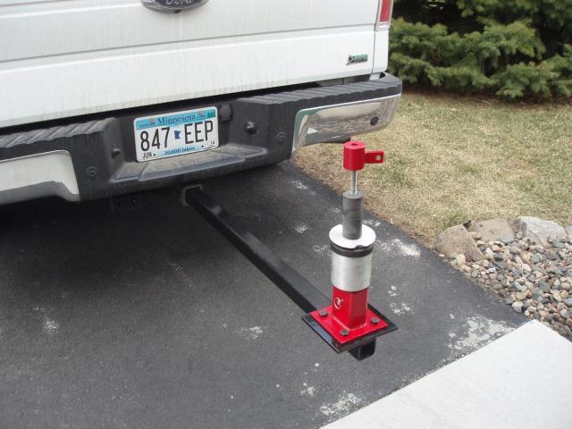

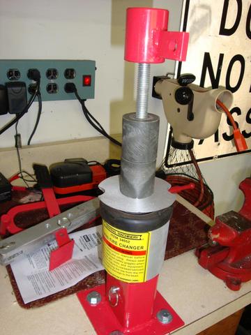

Terry M-(Moderator) 2,141 #19 Posted April 15, 2014 Made this mount for my harbor freight mini tire changer. I hope its as easy to change tires as it looks in the videos. 4 Share this post Link to post Share on other sites

HorseFixer 2,012 #21 Posted April 15, 2014 Made this mount for my harbor freight mini tire changer. I hope its as easy to change tires as it looks in the videos. Great Idea I like yer Style! May hafta build one myself! ~Duke 1 Share this post Link to post Share on other sites
bowtieguy 334 #22 Posted April 15, 2014 I welded a long bolt on top of the larger HF tire changer...2.small disc blades (same size to fit inside 8" rim) put one blade on bottom, then tire and rim, then another blade on top...run nut down on bolt to hold rim in place.....and you are ready to work on the tire...works for me..poor guys have poor ways!!! 3 Share this post Link to post Share on other sites
doc724 924 #23 Posted April 15, 2014 Terry, I like your idea. I have mine bolted to a work bench. It works but it is a little more difficult since the tire is about chest high when I am trying to wrestle it on. I also bought a couple of cheap squeeze clamps from harbor freight to squeeze the tire together to get it into the smallest part of the rim when trying to get the second bead installed. You may not need them but as an older guy, I need all the help I can get! Share this post Link to post Share on other sites
posifour11 723 #24 Posted April 25, 2014 Frank, really like your idea. 1 Share this post Link to post Share on other sites
