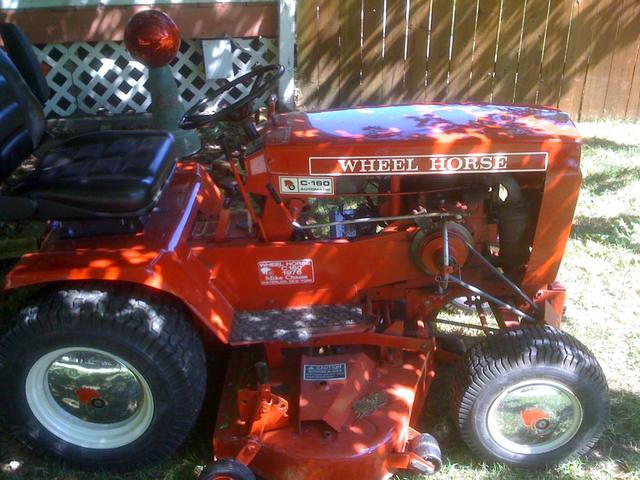

mac64 0 #1 Posted August 14, 2012 I`m new to the site,but have been into these tractors for a long time.I need help with making a decision,i`ve recently puchased a 160c w/hydro and a 417a twin 16hp Kohler also Hydro.They both run and are in good condition,here`s the thing I can only keep one.I use my tractor a lot,so which one would be the best choice?? Share this post Link to post Share on other sites

546cowboy 302 #4 Posted August 15, 2012 I would suggest you keep the C-160 because of the engine. Those 17 horse Kohler Twins chuck rods on a regular basis. Especially if it is a Series I. I have a 417A sitting here now with a broken rod and I have a C175 here that I think needs valves adjusted or a vavle job. I have had three of the K-17's and two of those with broken rods. Those K-341's will run forever if you take care of them. :WRS: Share this post Link to post Share on other sites
Tankman 3,528 #5 Posted August 15, 2012 Agree with the other members, "hang on to the C-160." As noted, the twin cylinders have been known as, "trouble makers." Share this post Link to post Share on other sites

Docwheelhorse 2,992 #13 Posted August 23, 2012 Hi-- heres my .02... The 160 is a better overall tractor ---but--- the weak link in the 160 is the Sundstrand transmission---obsolete and difficult/very expensive to rebuild. the weak link in the 417 is the motor ---but--- it has the Eaton 1100 which is grenade proof I prefer the 160 in the looks, sheet metal, better dash tower setup and of course the big one lunger... but that trani sticks out. If I could keep only one and was going to run it hard I would do the following..... pull the motor out of the 160 and put it into the 417 and don't look back. EXCEPT that the Kohler twin won't go into the 160 and allow its hood to close. at least I don't think so. So in the end you just need to make sure that the 160 trani is good and take care of it....... run the tractor and get the transmission good and hot and make sure it doesn't go soft. some help I've been Tony Share this post Link to post Share on other sites
