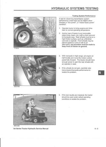

shallowwatersailor 3,222 #7 Posted August 17, 2012 My 518xi has served me well and has done everything that I wanted. The only weak spot that I have found in 2 1/2 years of ownership have been the hydraulic hoses weeping. That's a minor issue. The powersteering would be a nice feature because I would think that with the Kwik-Way loaded it would almost be a necessity. I have a large number of trees that I need to dodge when mowing, but the manual steering is not bad without additional weight of an attachment on the front when mowing. I have always wondered if it is the same quick steering arrangement as the late 520Hs? Tire sizes should be: Front 16X7.50-8 and Rear 23X10.50-12. The front is an odd size that can only be found in a turf pattern, but in a previous post I researched the Vredestein V61 as an alternative. The 5xi Series Tractor Hydraulic Service Manual on page 5-3 has the performance test that you can use to determine how strong the hydraulics are. It is a very strong tractor. I would love to have a second one if my Johnny Bucket would fit. Good Luck with your decision! Share this post Link to post Share on other sites
Forest Road 595 #8 Posted August 17, 2012 Thanks for the testing info!!!! I can t wait to walk into the dealer with a chain and a copy of that page. Maybe ill bring a camera for their reactions. I asked my local toro/WH dealer how to test and he said to use a hydro gauge set. Obviously that wontthe happen. So this is huge! Many thanks! Share this post Link to post Share on other sites
