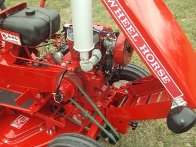

Retired Wrencher 7,034 #6 Posted August 5, 2012 :USA: Ford/69 what do u think of these??? they all work fine with no problems Share this post Link to post Share on other sites
Fordiesel69 274 #7 Posted August 6, 2012 All look great!!!!!!!!!!! I would love to own that old 1075. Share this post Link to post Share on other sites

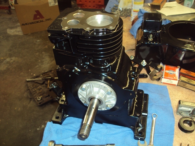

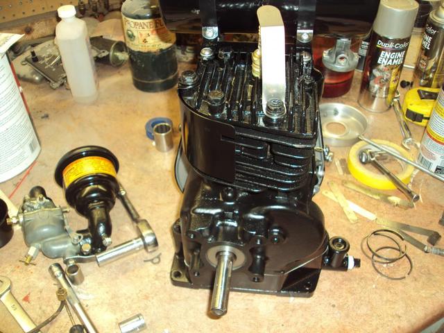

bowtiebutler956 650 #9 Posted August 7, 2012 I usually paint mine. I use VHT engine enamel. Matt The first is the K301 in my B-80, the second is the 1952 Briggs 9FB in my sons Bantam, and the third is a 1953 Briggs Model N. Share this post Link to post Share on other sites
