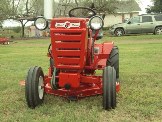

bowtiebutler956 650 #8 Posted August 5, 2012 Here is the one on my B-80. Matt :flags-texas: Share this post Link to post Share on other sites
