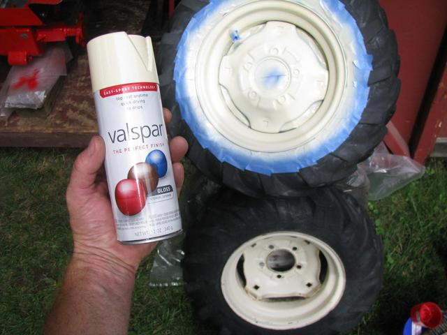

AMC RULES 37,261 #2 Posted July 28, 2012 Should work, no problem. Just let the air out of the tire to get the tape mask under the edge of the rim. I used a high heat, pressure washer to blast the paint off the rear of these, scuffed 'em up with a red scotch brite, then repainted...I left the front of 'em the original paint because they still looked pretty good. Share this post Link to post Share on other sites

AMC RULES 37,261 #7 Posted July 28, 2012 Masking a tire on the rim with small 2-3 inch pieces of blue painter tape, torn from a roll, and slipping the straight edge of each piece under the rim bead...might take all of three minutes to do. If you take the tape off, in reverse order, as soon as you're done spraying...you can even reuse them again on the next rim you're spraying. When you apply the tape, you only need to barely touch it to hold it in place. Masking in this way serves to make the process go very quickly. Share this post Link to post Share on other sites

kpinnc 19,107 #13 Posted July 31, 2012 Even when using new tires, I always paint the wheels (the outside of the wheel anyway) with the tires at least mounted. You can paint the inside of the rims, then mount the tires, and use masking tape and newspaper or garbage bags to cover the tires. After painting, just inflate the tires. No scratched rims, and the "masked" tires are good to handle the wheels without messing them up before the paint cures. If the tires are difficult to seat the beads, at least you can handle them a bit rougher without scratching up the wheels. 1 Share this post Link to post Share on other sites
APPALACHIAN EDGE 18 #14 Posted July 31, 2012 Im new to join but follow this site alot, just not much on typing alot! I happen to be painting a set of wheels at the moment & over the yrs. ive found that letting some air pressure out & tucking my used shop rags around under the rims with a flat screwdriver is the fastest way to go for me! Let one side cure while working on something else & come back & do the other sides! Just my 2 cents worth lol! 1 Share this post Link to post Share on other sites
