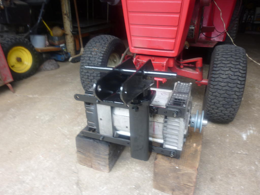

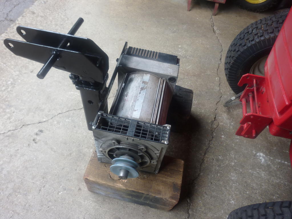

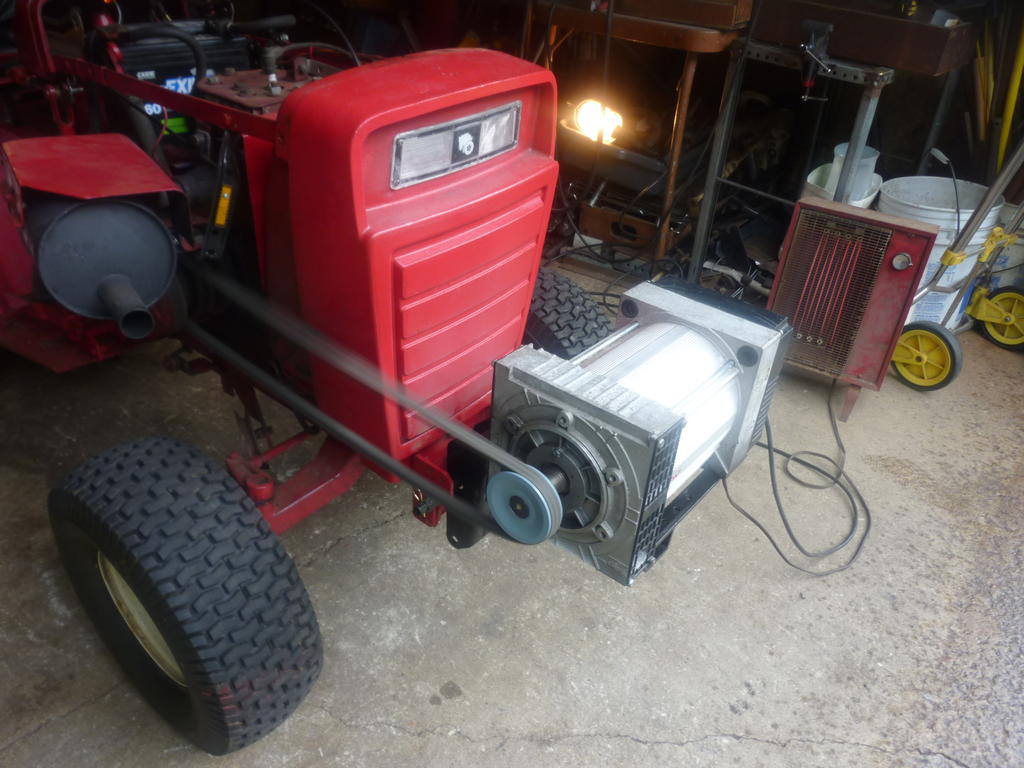

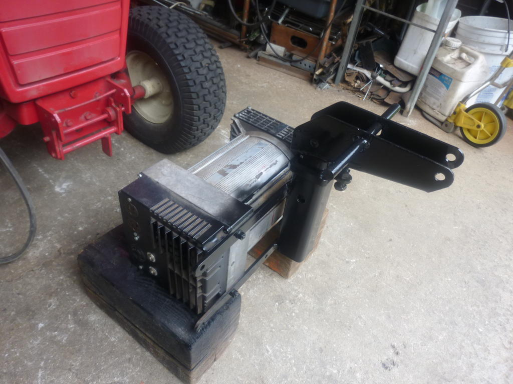

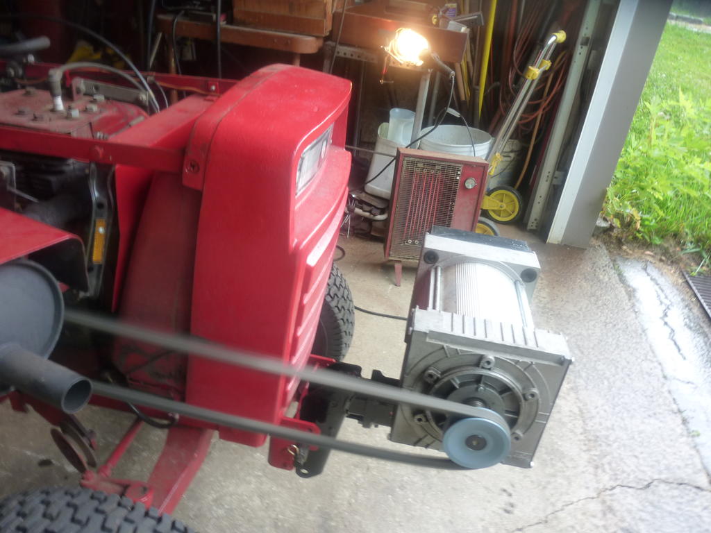

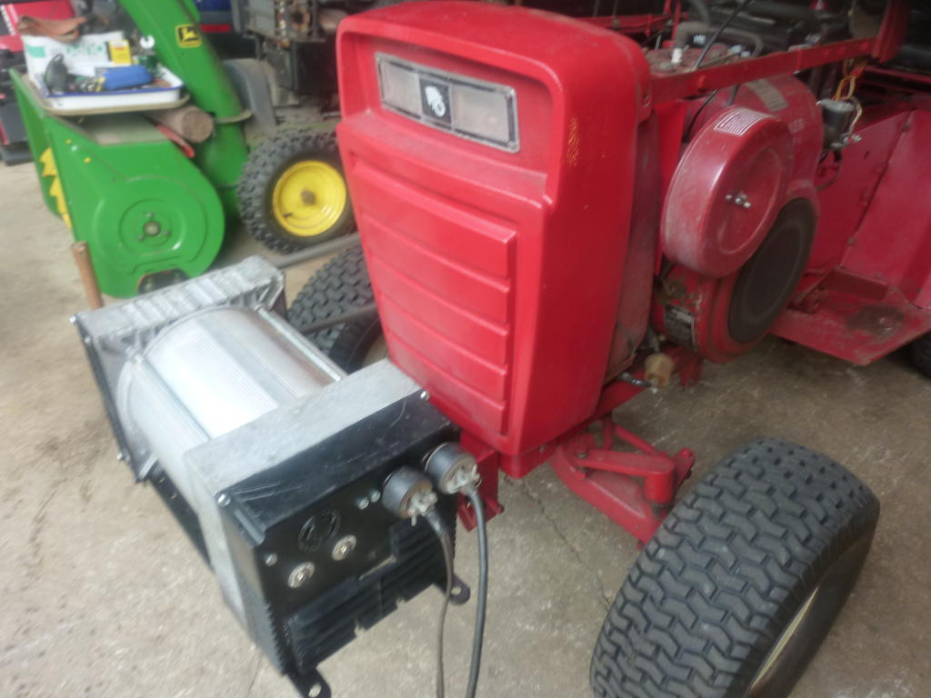

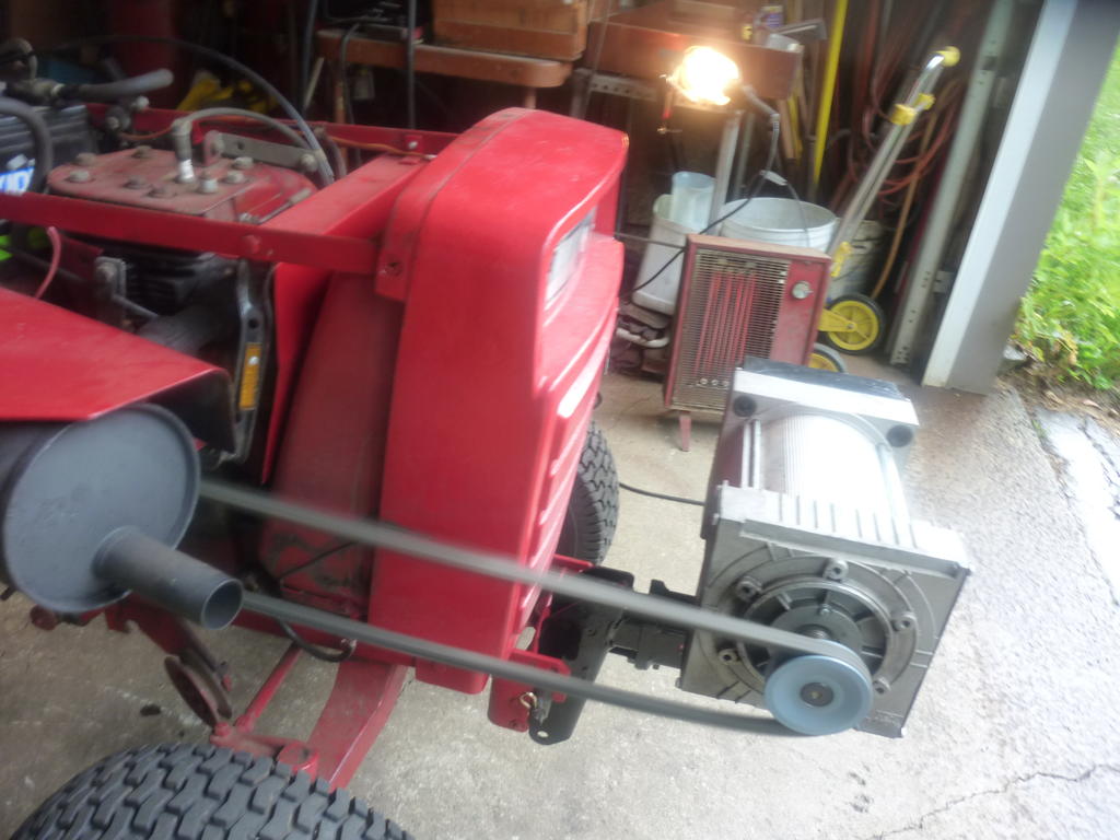

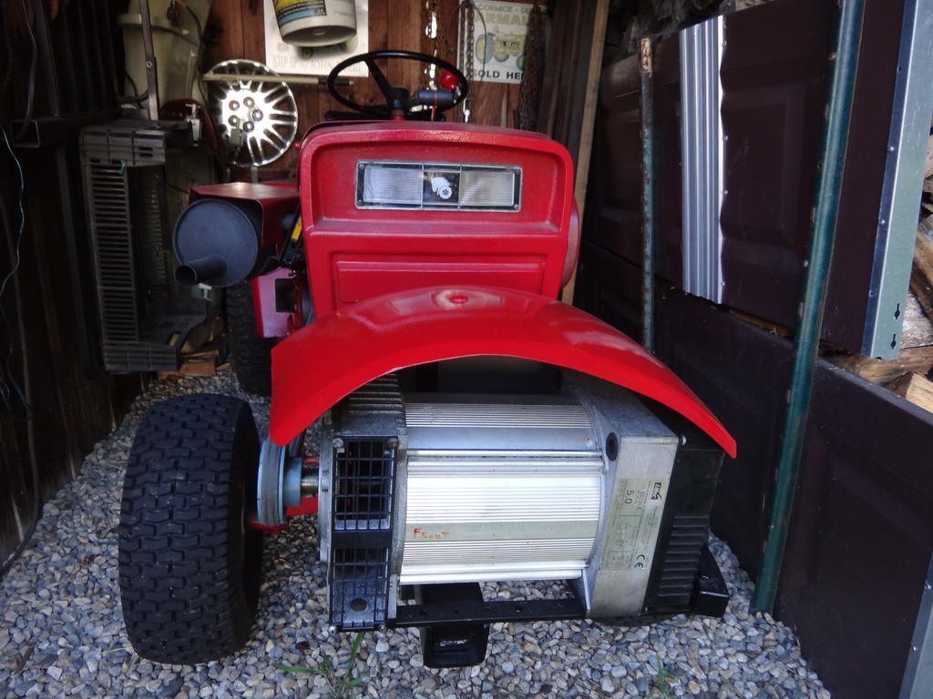

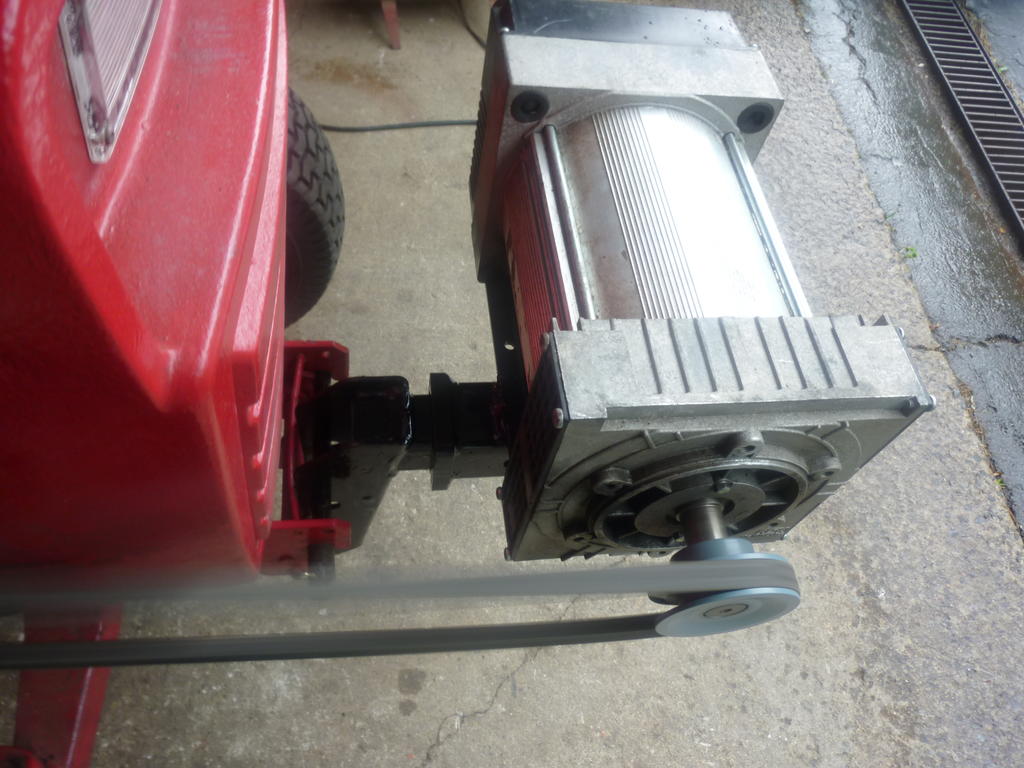

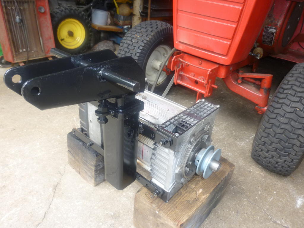

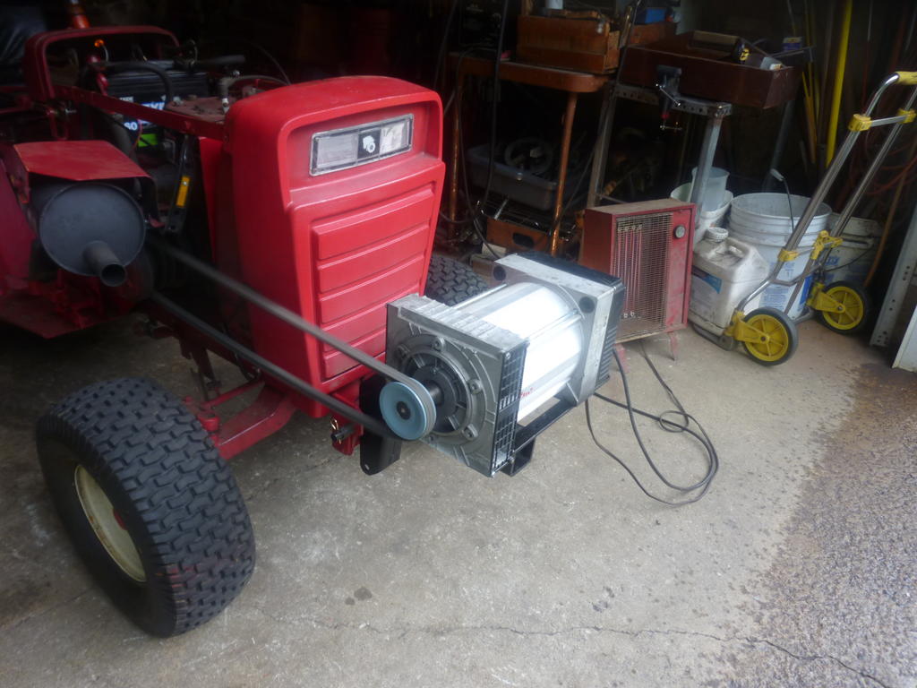

Rob R 989 #13 Posted October 9, 2018 I made one using the attach-o-matic mount which I mounted on the front of a GT14 gen is from Harbor Freight. Works great! 3 Share this post Link to post Share on other sites
ebinmaine 80,325 #14 Posted October 9, 2018 22 minutes ago, Rob R said: made one Rob thanks for posting that. I'm thinking of dedicating one of my tractors to be a mobile generator for us here. We do lose power four to six times a year here in the wooded mountains. I have a 60s or 70s vintage Sears generator attachment already. I need to have somebody make up one of these brackets for me... Couple questions. How do you know what belt length to use? Just a matter of experimentation and measurement I suppose. Also, what keeps tension on the Belt while it is in operation? Thanks a bunch. Eric Share this post Link to post Share on other sites
Rob R 989 #15 Posted October 9, 2018 17 minutes ago, ebinmaine said: Rob thanks for posting that. I'm thinking of dedicating one of my tractors to be a mobile generator for us here. We do lose power four to six times a year here in the wooded mountains. I have a 60s or 70s vintage Sears generator attachment already. I need to have somebody make up one of these brackets for me... Couple questions. How do you know what belt length to use? Just a matter of experimentation and measurement I suppose. Also, what keeps tension on the Belt while it is in operation? Thanks a bunch. Eric Eric, if you look closely at I think the 2nd pic you will see I devised a bolt and welded nut with a locking nut so which I can tighten if needed this is one of the key reasons I used the 2 inch channel so that I could make this work easily. I have a pretty good stock of belts and used one that fit within the parameters of the aforementioned nut ….. one of the great things is that so far I have used it quite a bit (with all the storms we have had) with zero issues and have never needed to tighten the belt once set-up.... Share this post Link to post Share on other sites
ebinmaine 80,325 #16 Posted October 9, 2018 1 minute ago, Rob R said: Eric, if you look closely at I think the 2nd pic you will see I devised a bolt and welded nut with a locking nut so which I can tighten if needed this is one of the key reasons I used the 2 inch channel so that I could make this work easily. I have a pretty good stock of belts and used one that fit within the parameters of the aforementioned nut ….. one of the great things is that so far I have used it quite a bit (with all the storms we have had) with zero issues and have never needed to tighten the belt once set-up.... I thought that's what I was seeing but I'm looking at it on a little smartphone screen Share this post Link to post Share on other sites

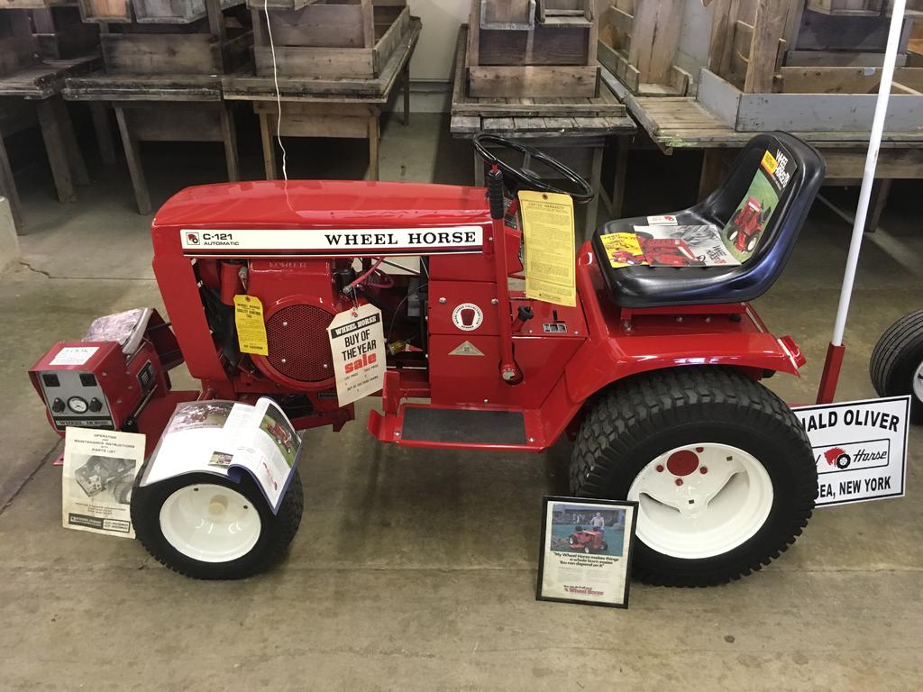

c-series don 12,363 #18 Posted October 10, 2018 Here is my 3000 watt generator. I was in the right place at the right time and got two for $300. Sold one for $150 to my Wheel Horse buddy. That was with the bracket and correct Wheel Horse belt. 3 Share this post Link to post Share on other sites
