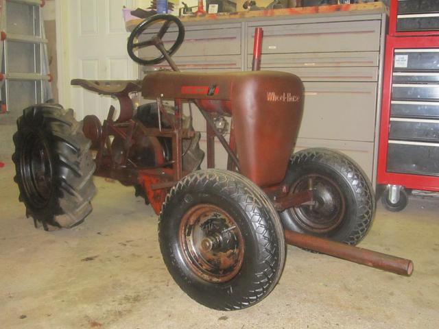

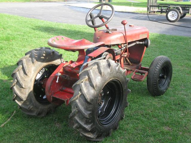

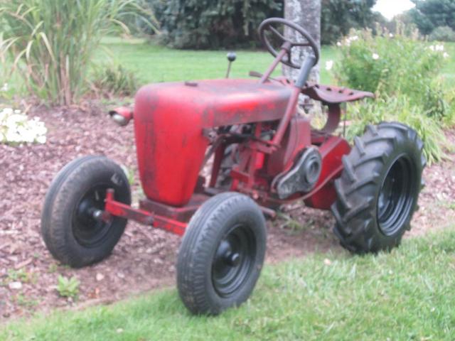

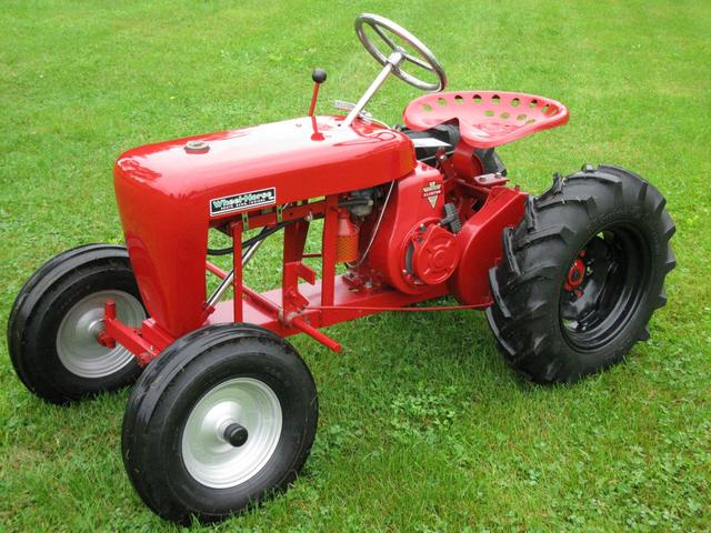

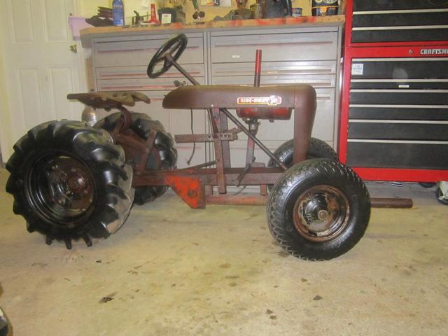

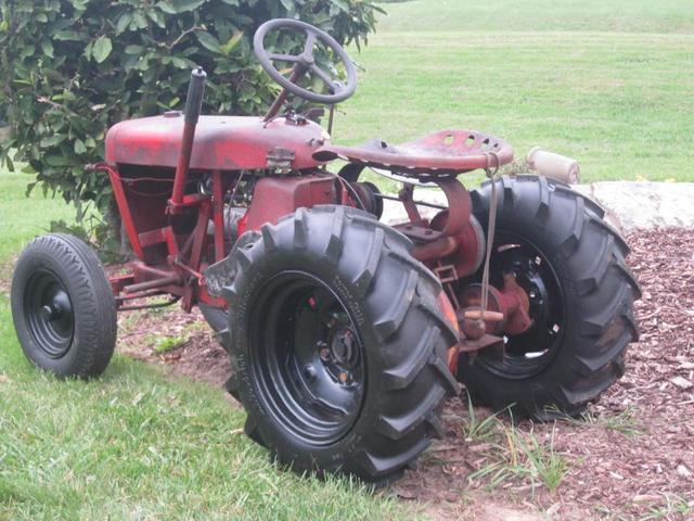

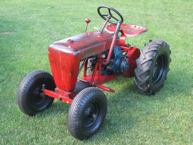

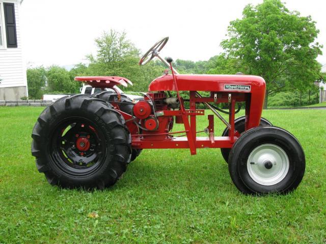

Jake,
Here are pics of my RJ35's. The only one I am positive on the year is the restored one with the alumium wheel the rest ? The other three I believe are late 55 or early 56 then 56 (electric start one) and I am stumped on the last one? Let me know if you need other pictures and which one and of what. It is better to show it here in this thread then to send emails. This way others can see as well for future reference.

Thanks for the help guys. Steve,those are some very nice rj's! Do you guys know where I can get a spring for it that will work? Thanks Jake
