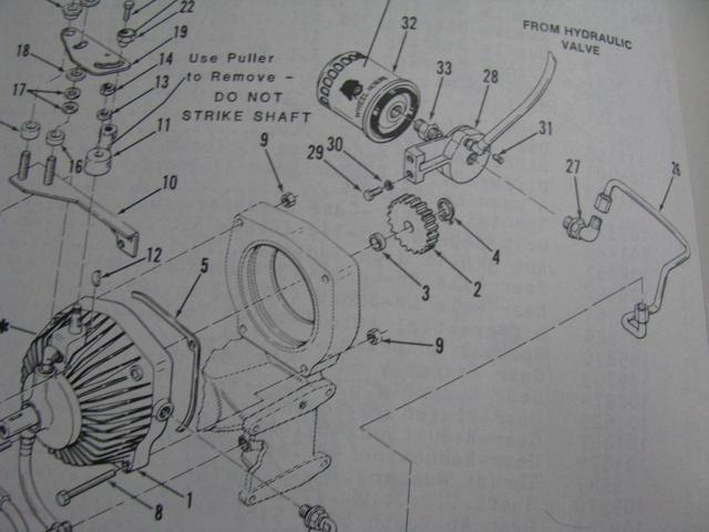

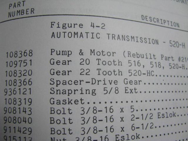

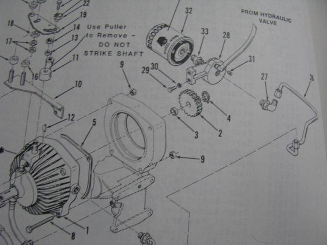

AMC RULES 36,955 #12 Posted August 1, 2012 Section 4, page 7 of the '88 500 series parts and service manual. Share this post Link to post Share on other sites

JackC 616 #14 Posted August 1, 2012 For the 1989 model year, the 520HC was rated at 7.50 mph compared to 6.4 mph for the 520H. The "C" stands for Commercial so maybe they made the 520HC go faster for the people mowing for a living? The 724-Z was only a little faster at 8.0 mph. My 1989 520HC fells like if flies compared to my 1994 416H and my 1996 314H that are both rated at 5.6mph and same as the 520H. The 520HC is not quite as fancy but it will out run any 520H. Here is my 520HC: Share this post Link to post Share on other sites
smoreau 658 #15 Posted August 2, 2012 Ok here is what I know on this issue. the early eaton 1100 that came in the c125-175 black hoods to 85 417A's all had the faster trans. 86 and newer was hit and mis. some of the 520's went faster then others. My 90 flys! my 96 came with the slower gears and they got changed with the gears out of a c125 black hood. I took some pics and here they are. there is more then 2 gears that are different. Share this post Link to post Share on other sites
