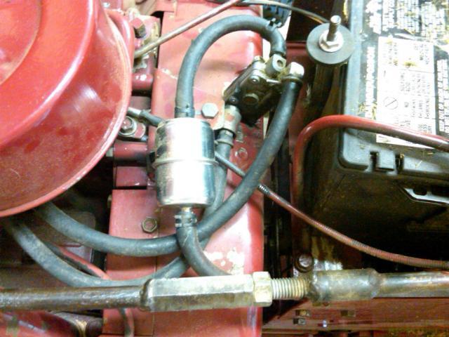

Here is a picture of the clear 1/4 inch fuel line on my 1977 D-160.
It really helps to see how the fuel delivery is working.

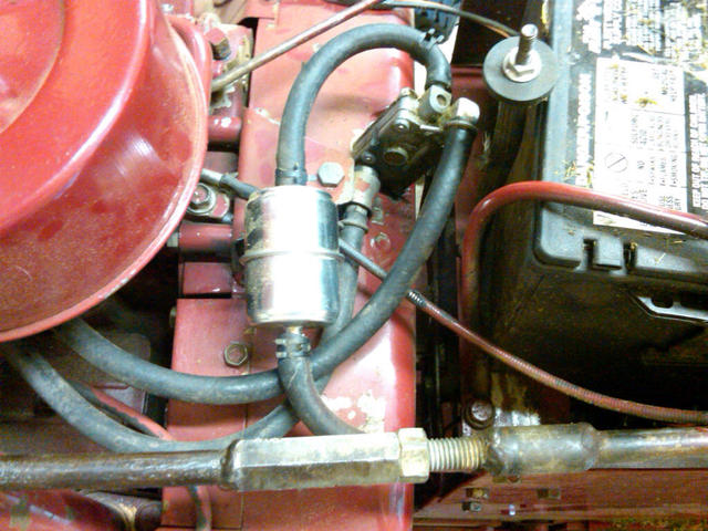

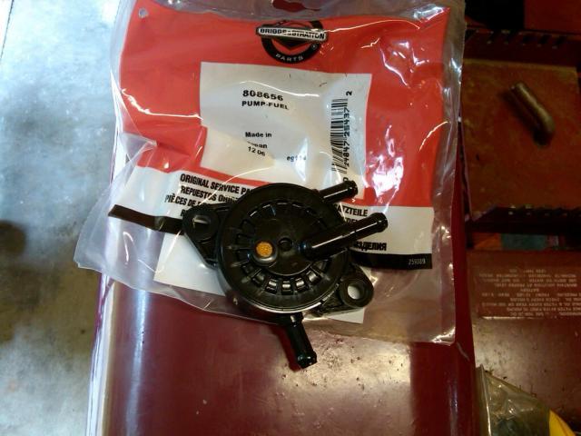

tommyg
After picking up some seals from the local Toro dealer, I asked him about whether or not there was a replacement pump available like the one I currently had. He handed me this one... manufactured by Briggs. For $19.99, I decided to give it a try.
post-5507-0-44334800-1344311006_thumb.jp
This was my existing set up. I replaced the metal filter with a see through plastic filter. There were no directions with the new pump, so I was a bit perplexed as to what connected to where. I used an extremely low tech, perhaps even primal decision making process. I stuck it in my mouth and sucked on both the old one and the new one. There was one end that I could not suck any air through on both units. So I assumed this was inlet side of the pump. Another was marked with a "P". I assumed this meant "pulse". So I hooked this up to the vacuum hose. Of course, there was only one left, so I hooked that up to the carb. To my delight, I got it right the first time! The mounting holes lined up almost perfectly with the threads for the old pump and where my choke cable was bolted down.

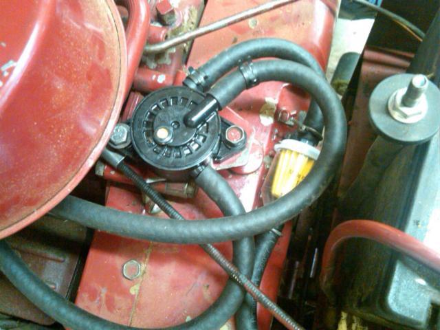

post-5507-0-26724200-1344311007_thumb.jp
Here's my final set up. Works great!!!
