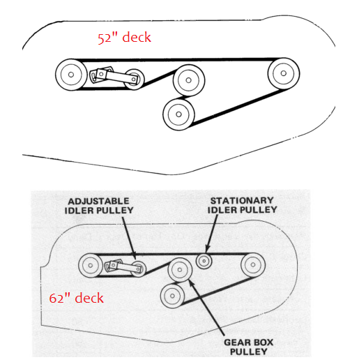

TT-(Moderator) 1,188 #26 Posted June 17, 2013 I know there are 52" and 62" decks for the GM220 models. Here's the routing diagrams for both: What is the model number of the deck on your 220? Share this post Link to post Share on other sites

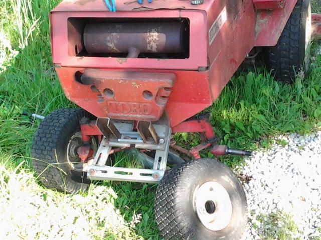

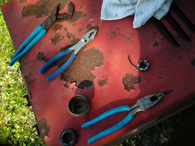

TheAnonymousThomas 0 #27 Posted June 19, 2013 the 62 is the right one for me, Thanks TT. NExt problem is that my back tires got holes in them and there's a cap that i can't get off. any ideas? Share this post Link to post Share on other sites
TT-(Moderator) 1,188 #28 Posted June 19, 2013 The dust caps on the rear hubs pull off. I use slip joint pliers. (a.k.a. ~ Channel Locks) This might help: http://www.autozone.com/autozone/repairinfo/common/repairInfoMain.jsp?targetPage=productsHowToInspect&leftNavPage=productsHowTo&pageId=%090900c1528021404e&subtitle=replace Share this post Link to post Share on other sites

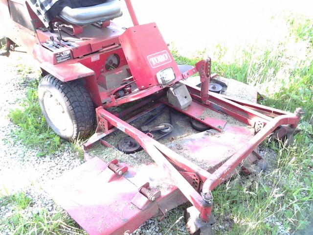

TheAnonymousThomas 0 #29 Posted June 19, 2013 Thanks for that TT, here's a shot of my deck... Here's the back. Where my current problem is... And my weapons of choice... Share this post Link to post Share on other sites
