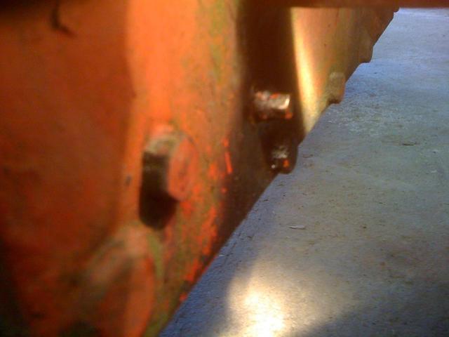

squonk 48,209 #5 Posted July 15, 2012 Here's a pic of the only plug in the side of the trans. Maybe in 59 they did away with the 2nd plug? The only other plug I find is on the top. Nothing on the bottom either. Share this post Link to post Share on other sites
stevasaurus 23,857 #6 Posted July 16, 2012 That is the check plug Mike...fill trans until it starts to run out that hole. I know it looks like it should be higher, but it is enough for the gears to run through the oil. Edit...I went back and looked at my pictures, and I saw no drain plug on the bottom either. You may have to drop the right wheel and tip the horse to drain it out that check hole. How does the fluid in the trans look?? 1 Share this post Link to post Share on other sites
squonk 48,209 #7 Posted July 16, 2012 That's how I drained it. Took off the wheel and cranked up the left side. Oil looked knarly. I flushed out the trans and put in a mixture of 90 wt gear lube and some Lucas oil stabilizer. It worked wonders on my Power King Share this post Link to post Share on other sites
stevasaurus 23,857 #8 Posted July 16, 2012 Cool, you should be OK. You may want to put a few hours on it and re drain and refill in the spring if the old oil is suspect. You need good oil on these little guys. There is no axle bearings...just brass bushings on both ends of the axles. Share this post Link to post Share on other sites
specialwheelhorse 174 #9 Posted September 19, 2012 Hey Fella's You have about six drain plugs on these trany's. Pull any one of the 5/16s bolts out of the bottom of the case as these all pass thru the center section and will drain. Just put a little hooky gooky on the bolt when you fasten it up to prevent any leakage.And while got it drained if you notice any leakage around any of the other bolts pull them out one at a time and gooky them as well. Jim in TEXAS Share this post Link to post Share on other sites
stevasaurus 23,857 #10 Posted September 20, 2012 You know Jim, you are absolutely right, any one of those bottom bolts would work to drain the oil without messing up the gasket. Good call mate...thanks. :) 1 Share this post Link to post Share on other sites
