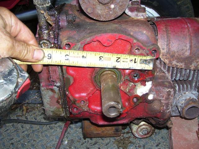

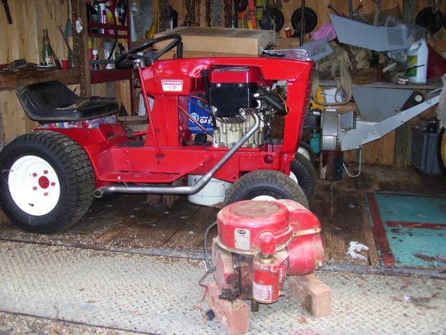

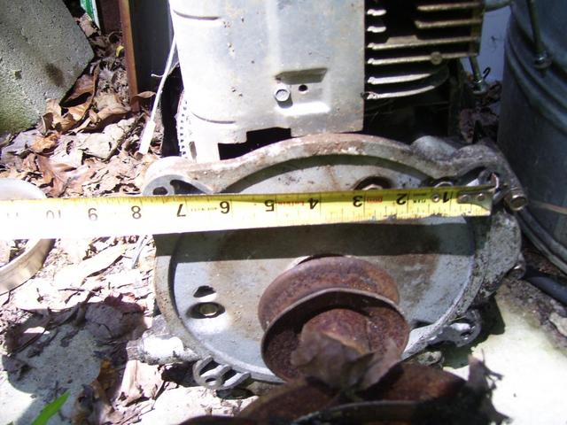

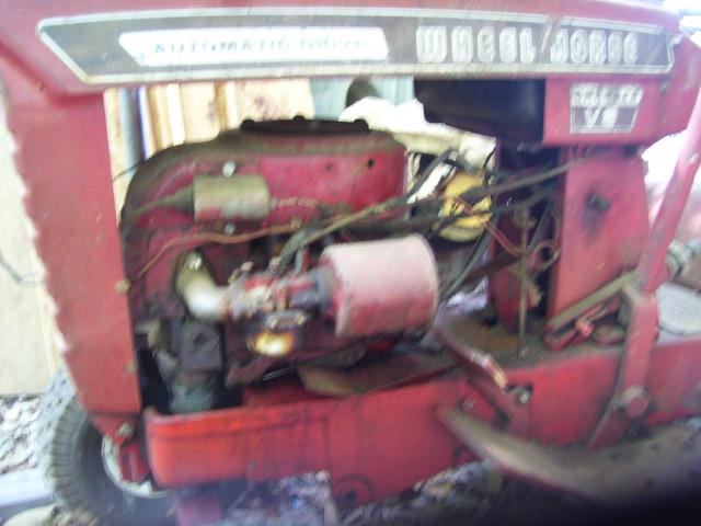

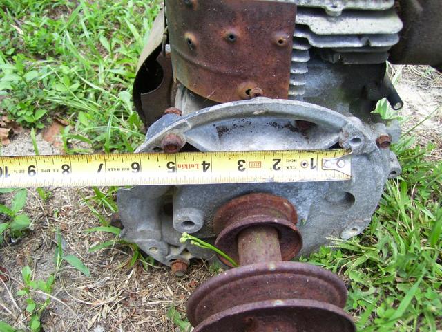

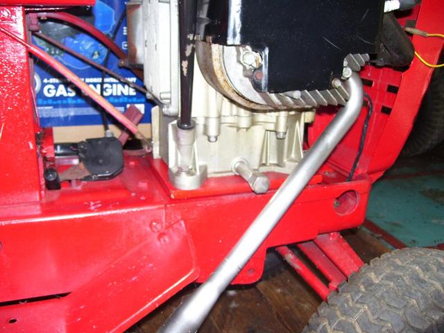

jay in nc 211 #2 Posted July 14, 2012 darren i repowered a commando v8 with a b&s 16 hp twin to do so you need a piece of 1/2 in. steel plate with a hole for the crankshaft to go through, then drill & tap 4 3/8 holes to bolt this plate to the tractor, then drill& tap 4 3/8 holes in it to match the bolt pattern of the doner engine. you will have to drill the threads out of the block ,then bolt the plate to the tractor, then the engine to the plate & thats it. also heres pictures of the bolt patterns of a kv181 kohler, b&s 12 hp vert. single, & a 7 hp vert tecumpseh as well as a picture of my stock charger v8 with kv181 power the easyst is a replacement kohler, rare & pricey, tecky somewhat rare & pricey, or B & S common as white work trucks at a construction site but the bolt pattern is wrong & with the cast iron front frame section requires an addaptor plate. hope this helps. Jay Share this post Link to post Share on other sites
darren 49 #3 Posted July 14, 2012 That's really useful Jay, especially the pictures. Thanks very much The KV181 looks a beaut! The Kohler'd always been my preference but if they're rare your side of the pond, they're going to be unobtainable here (weren't they only made for 2 years?) I think the practical route is going to be the B&S one. I'll have a scout around for a smallish output one and post pictures on how it goes! Share this post Link to post Share on other sites
