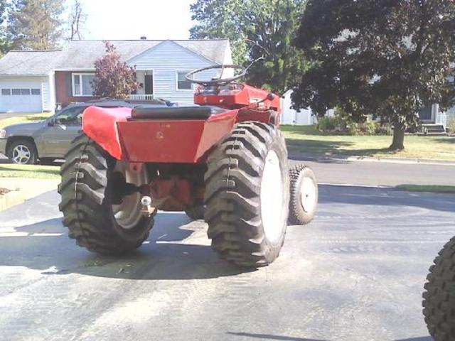

HorseWhisperer 243 #7 Posted July 1, 2012 (edited) Duane-9.5.3.10.54 weights.Don't make me call!In the great words of Yogi Berra Money is as good as cash!Tom,wider is great on dry grass,sand and most mud!6x12 is GREAT for snow and real traction-smaller contact patch=more pressure and more traction!I just changed the tires from 6x12 to 12x12 for summer! Edited July 1, 2012 by commandomayo Share this post Link to post Share on other sites
