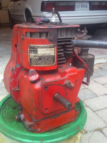

When you paint an engine, do you use the Valspar IH paint? Can it handle the heat? Getting ready to paint a Clinton engine that goes in my RJ.

i am not an expert at all but i used automotive engine paint and it didnt do to bad,its wearing now after a few months,but i used reg paint a few years ago and it burnt up right away
Ryan H
My engine on my tractor was painted with the valspar IH red it only burns a little but all the covers are fine, acually i think even the block is fine too.
KATO
I' ve used the regular paint on a few engines , seems fine. It will definitely burn up
around the exhaust on the fins, but you shouldn't paint cooling fins or cylinder head anyhow.....
in my opinion.
KEN
Kelly
We used Valspar resto paint sprayed with a gun and had hardener in it on Ryans and Nicks tractors, I bet Ryan has ran 40 tanks of gas through his tractor and it is only burnt at the exh port, it still looks very good.
