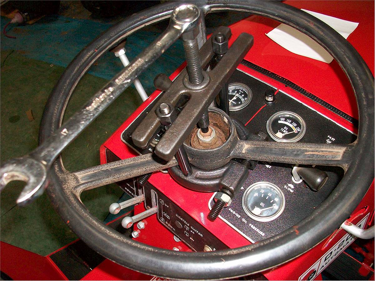

Ok guys - so how do you rate my chances?
Hmm... not good I guess but then that was why I've worked round it so far.
The puller set arrived today and I began the soaking process. In view of the amount of rust I decided there was no point even taking the air wrench to the nut at this stage.

For an lesser mortal, I would say your chances are slim to none. But in your case . . .
Dunno why you wouldn't take an impact driver to the nut. It's so rusted, what do you have to loose? I don't see what other options you have besides a socket and a breaker bar.
Just remember, don't use the blue wrench. There's too much plastic in proximity, and it will probably melt. I think Jeff has some pics of a PO's attempt at that.
rmaynard
Chances? On a scale of 1 to 5, I'd say 3. The nut does not look like it has been abused, and a good soak with something like PB Blaster will start to loosen the rust on the threads and the shaft. I'd much rather be taking my chance with that than to try to get a rusted roll pin out of a C-series. At least with a nut, if it doesn't loosen, you can always split it with a chisel.

Thats how both of mine looked and after the soaking with pb blaster the nut came off real easy with my impact. That is not your main issue though, getting the steering wheel to free its self from the splined shaft is the FUN part.
By the looks of what you posted...well not a good sight. Like I said thats how mine looked and neither would come off.

The nut would probably have come off with the impact wrench but having read the reports about stripped threads and mushroomed shaft, I decided to let it soak overnight first. It'll also give me a chance to see if the treads got penetrated.
Good luck to ya :)
I'm not under any illusions here, and I was resigned to living with it 'as is' until I watched the video which kind of made me think that I'd have to at least give it a try.
Will keep you all posted.

Ok so here's what I've done so far.....
Yesterday, scraped off as much of the rusty crud as I could with a sharp scredriver, particularly round the top of the thread and round the base of the nut. Added a splash of acetone to some diesel (not sure that the acetone would make a whole lot of difference but worth trying) and applied it round the top of the thread and base of the nut with a soft artist's paint brush. After half an hour it had mainly gone in so applied a little more and, as usual with pentrating fluids of most types, the absorption rate got slower. Made a final application at the end of the day and left overnite.
As has been suggested, my impact wrench that runs off the compressed air line would have taken the nut off straight away without soaking in fluid - it's never yet failed to remove those badly rusted nuts that hold the blades onto deck spindles but soaking the nut first was a kind of test.
In the morning the fluid had disappeared somewhere - the acetone would have evaporated but there was nothing left to see.
Decided not to use the air operated impact, opting for the cordless battery one that's a bit gentler than 'old faithful' and with a rat-a tat-tat the nut was off. The encouraging thing was that the whole of the thread was 'wet' with a black rust and fluid mix and the nut would spin up and down the thread by finger tips without any cleaning so there's hope for the splines yet!
The diesel had made it down as far as the top of the splines so I cleared out the softened crud sitting in the recess before the splines start using a small craft knife. Once removed, I could feel the tops of the splines as the tip of the blade ran across them.
After a couple of applications I've left a little pool in the recess to soak in overnite. I suspect slower progress re soaking in down the splines so it could take a couple of days but I left a clean sheet of white paper wedged between the bottom of the steering wheel boss and the foam washer thingy to let me know visibly if anything's got through by the morning.
Thanks for all the hints and tips guys, I'm a little more optimistic about the chances of success than I was at the start but I'm not going to try to 'pull it off' (as the saying goes) until the fluid's reached the other end of the splines. I'm also very aware that some of you have already given this job your best shot and failed to budge it so I don't think it's worth betting on my chances either way at this stage.

The diesel had been left to soak in for about 24 hours but nothing had come through onto my piece of paper (discovered the reason later). I had intended to apply some more and leave again but temptation got the better of me so out came the puller set that I'd got off a well known auction site. Cost me £20 + shipping.

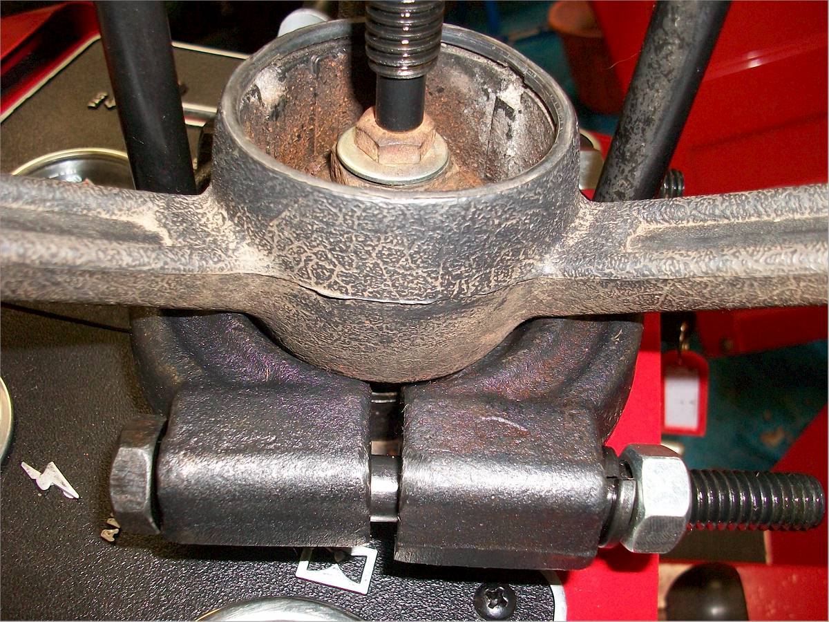

Assembled the necessary bits in place around the steering wheel...
The nut on the steering wheel shaft was adjusted to be flush with the end of the shaft and a bolt with a couple of washers on it placed into the hollow centre to the shaft.
The two halves of the puller were not done up tightly, just adjusted to be a snug fit round the steering wheel boss without clamping together on the shaft.
So with everything lined up squarely....
Tightened the puller bolt using a hand wrench till it was a tight as I could get it.
Before anyone says 'he's mad - use the impact wrench!' - this was all a bit of an experiment so I wanted to try avoiding too much brute force unless it was really needed.
Anyway, a couple of sharp taps squarely on the end of the puller bolt with what was actually a fairly small hammer and I heard the note change. Sure enough the puller bolt could be turned using the wrench and the splines were on the move.
Slackened off the puller enough to remove the bolt with washers and the steering wheel nut then replaced the bolt with its washers so that the puller could be used again. Using the hand wrench it was fairly stiff but on the move and......
Off came the steering wheel. Sorry about the quality of photo here, didn't notice what the auto focus had locked on to. I'll get the hang of my camera one day!
You'll see that the diesel had made it down to the bottom of the splines. The reason it didn't leave a tell-tale mark on the piece of paper was that the splines actually only go about half way down the steering boss so that they're tucked up out of the way where rain can't get to them. I was also fortunate I guess that the foam washer thingy had remained intact and had done a good job of stopping too much damp geting up there. The rusting on mine had occurred from top downwards I guess.
So there it is - if you did put any money down on this then I hope you won. It's hard to say whether acetone /ATF would have been better but the diesel certainly did the trick for me. It's obviously impossible to say how badly rusted the splines were on mine compared with other cases but I still had the impact wrench if needed so I guess they could have been worse and still come off with that.
