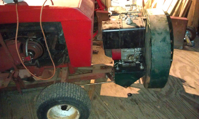

Here's the story. I have this HUGE walk-behind leaf blower and my property is a 1/2 acre (sloped). It is a bear to push this thing around so here's what I did:
I pulled the blade off the plow frame of my "work" tractor. I then removed ALL three wheels off of the walk behind blower. I pushed a thinner axle through one side of the blower's axle hole, then through the existing holes in the plow frame and then out through the other side of the blower. At this point the blower is freely pivoting/hinged on the plow frame. I attached a chain from an existing hole in the plow frame and then attached it to one of the engine mounting bolts on the blower to keep it from falling forward. It is important for there to be a hinged like movement so if you have a sloped property your tractor - with the blower attached - it will "bend" and be flexible when you're going down a slope and get to the flat portion. You may even have to raise the blower a bit.
The picture shows how I attached the blower to the tractor. Note the chain holding the blower up.
post-5904-0-19840600-1338772360_thumb.jp

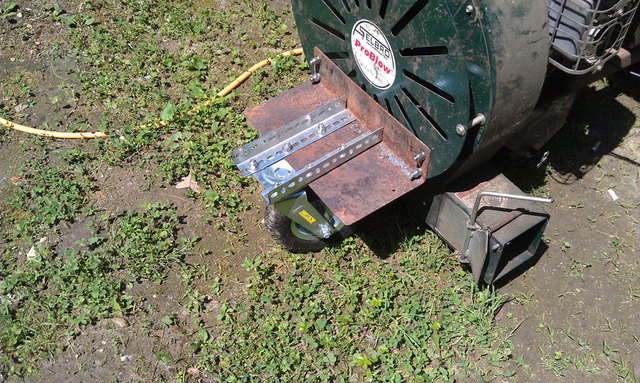

I went to Harbor Freight and bought an 8" swivel pneumatic tire to replace the stationary one that was on the blower. I stole the lip of an old hand truck that I had lying around and I had a piece of slotted angle iron in the shed. BTW, I used the axle from the old hand truck too. I'm sure we all have or had one of those orange cheapo hand trucks that converted to a "flat bed" by removing the handle. Yep, that one!
post-5904-0-73922200-1338773084_thumb.jp
Anyway, the whole thing worked fantastic! I was even able to angle the blower from the seat as though it was a plow blade. I am going to consider getting a smaller blower actually. I'm afraid I'm putting too much pressure on the hydraulics with this beast. Any thoughts on this? The front wheel does take some of the pressure off the tractor. Am I pushing it?
Thanks for looking. If I don't get any comments that suggest I might be killing the tractor, I'll put some time into a better "front wheel" design and paint it up!
