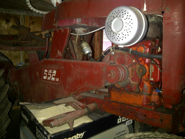

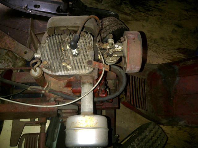

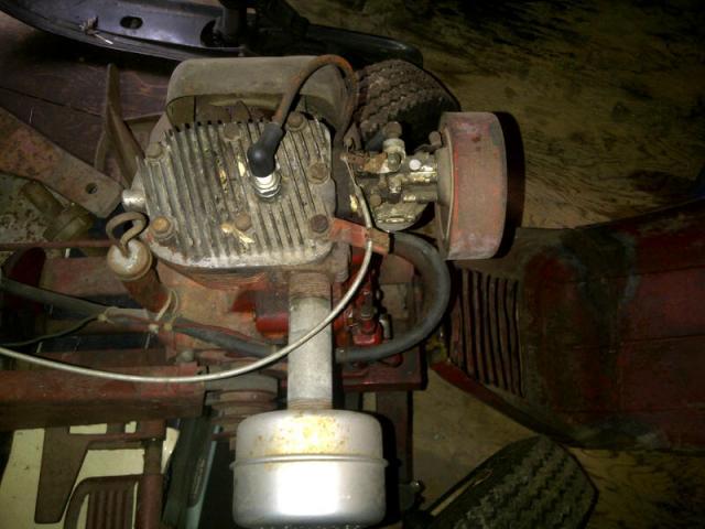

scoo 0 #1 Posted June 2, 2012 Hi there I bought this 552 about twenty years ago. The attached pics show the tractor as is with a Kohler engine. Not sure if the engine is the original one or not. The engine id plate is not readable. Can anyone tell me if this is a K161 or other model so I can buy the correct parts for the engine? http://i1252.photobu...elhorseeng1.jpg http://i1252.photobu...elhorseeng2.jpg Thanks very much, Scoo Share this post Link to post Share on other sites
Kelly 1,038 #2 Posted June 2, 2012 Well first that is not the orig. engine it would have came with a 5.5hp Lauson/Tecumseh engine, and as for IDing the Kohler we would need better pictures, and you may have to pull the head to measure the bore, remove the hood get pics of the front of the engine. And :WRS: Share this post Link to post Share on other sites

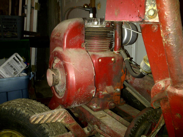

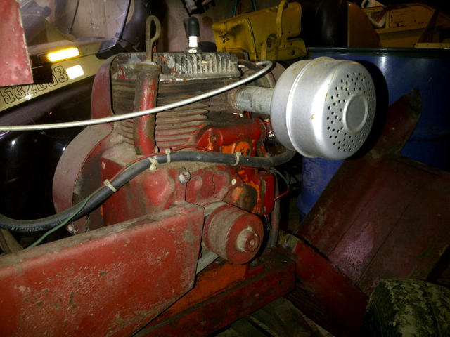

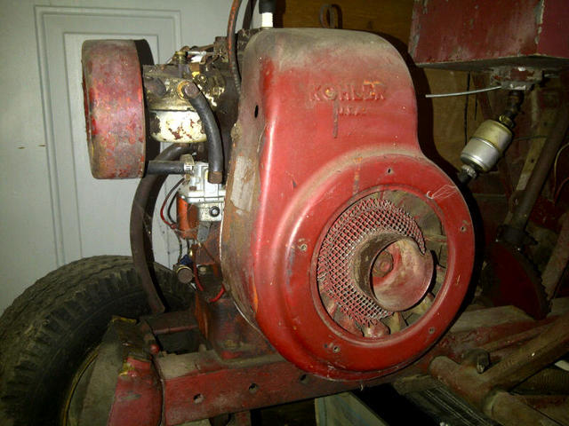

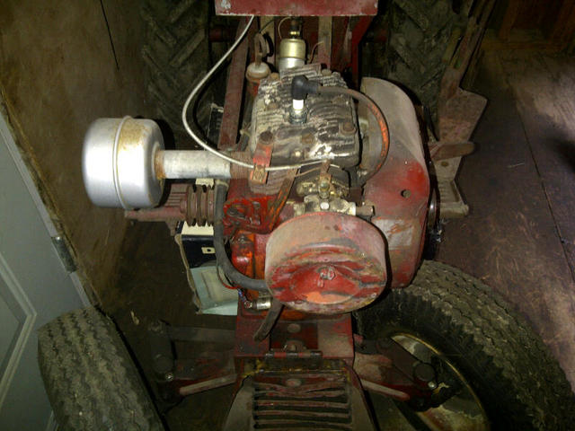

scoo 0 #3 Posted June 2, 2012 Thanks Kelly, attached are a couple more pics. Even if I could narrow it down to a couple of models that would help, without me having to pop the head. Share this post Link to post Share on other sites
tunahead72 2,623 #4 Posted June 3, 2012 It looks like your head has 7 bolts attaching it to the block, which I believe would make it either a K161 (7 HP) or K181 (8 HP). And likewise, :WRS: Share this post Link to post Share on other sites
