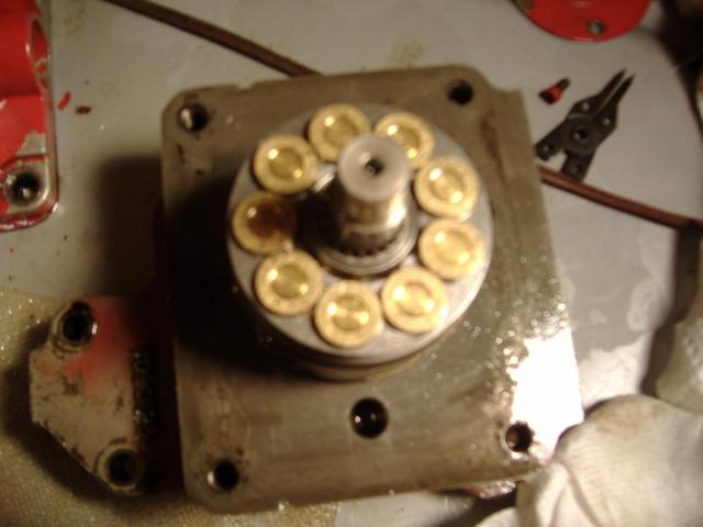

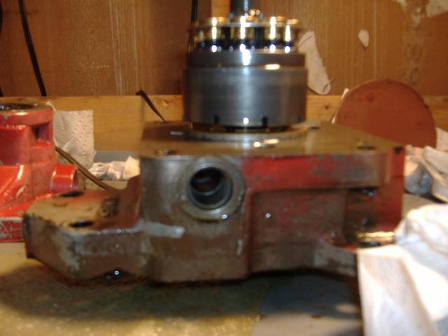

Here are a few pics of the motor and cylinder assy. Nothing special just wanted to post some for those that have not seen the insides.

I've been away for a few days so missed all of the excitement.
Great stuff, and excellent account and photos. :thumbs:
The really encouraging thing is that you've shown that it is possible to deal with pretty deep scoring when the manual describes it as a terminal condition requiring new parts.
