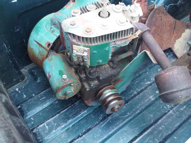

Pilot78 7 #1 Posted May 21, 2012 (edited) I picked up this engine along with the 603 out of Wyoming this weekend, the Wheel horse was located just off the old Oregon trail after it crossed the Sweet-water river. Attached are a few pictures of the haul and the Wyoming scenery. The only engine ID is a partial torn sticker that says 6 1/4 hp. The tin kinda makes it look like a Kohler. It has a starter but the data tag is faded and weathered and can only make out a few numbers but no info on a manufacturer. Any help would be appreciated. Brian SLC-Ut Edited May 21, 2012 by Pilot78 Share this post Link to post Share on other sites
bowtieguy 334 #2 Posted May 21, 2012 Probably not a Kohler engine....probably a Tucky motor that was on the 603....wonder what airplane is sporting the steering wheel that WAS on the 603? Engine tag might have been: Tecumseh H60-75016....which is a 6 hp.... Luv them ole round nose Wheel Horses! Share this post Link to post Share on other sites
CasualObserver 3,417 #3 Posted May 21, 2012 Definitely Tecumseh something. The engine shroud should have a tag on the side next to the carb. If it's not there, you'll probably see four holes forming the rectangle where it was riveted. That engine won't likely be original anyway... 603 models were the "economy" models... no electric start. Share this post Link to post Share on other sites
Kelly 1,038 #4 Posted May 22, 2012 If nothing else you have the corect drive pulley and exhaust brace for the 603, oh and yes that is a Tecumseh, sometimes there is a small tag held on by one of the side cover bolts, if it's there it will have stamped in it what the engine is, this tag is about 1/2" x 3/4" Share this post Link to post Share on other sites
