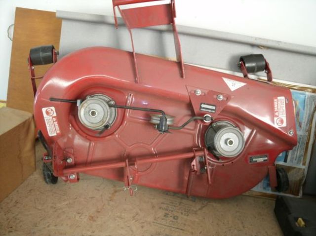

bean 85 #1 Posted May 19, 2012 will this deck fit a '73 8hp? it has the tach-a-matic and mule drive like all the later b,c, series tractors. it is a '37" and is nos. the guy wants $250 for it. seems a little high,( I am guessing) Share this post Link to post Share on other sites
bowtiebutler956 650 #2 Posted May 19, 2012 I think your going to run into some clearance problems with the tractor tires, but I could be wrong. I'm sure someone will jump in here shortly that knows for sure. Matt :flags-texas: Share this post Link to post Share on other sites
squonk 48,215 #3 Posted May 19, 2012 That looks just like the deck that was on my 210-H. I don't think it will work. That black bar sets the PTO tension off the vertical shaft engine electric clutch. Share this post Link to post Share on other sites
bean 85 #4 Posted May 19, 2012 that was my concern. the '73 8hp came with 20x8-10 tires on the rear, which are about 19' tall.. the ags I have on it are around 22" tall. That looks just like the deck that was on my 210-H. I don't think it will work. That black bar sets the PTO tension off the vertical shaft engine electric clutch. when i saw it, i thought it looked like a deck from a verticle shaft tractor. thanks Share this post Link to post Share on other sites
littleredrider 409 #5 Posted May 20, 2012 Get the model ID and run it thru parts tree or look thru the interchange, that would eliminate fitment questions. Share this post Link to post Share on other sites
Kelly 1,038 #6 Posted May 20, 2012 That deck will NOT fit, it is for a vert shaft mower. Share this post Link to post Share on other sites
