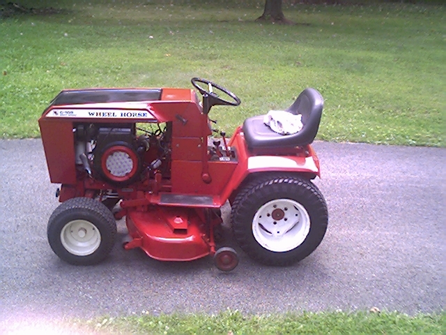

JimD 3,347 #16 Posted April 13, 2012 If pressured to build, I had been considering starting with a pair of those squarish trailer fenders and tying them into the existing foot boards. Then, bend up and weld in the seat pan and front apron, from 16ga. I would lose that ridiculous high ridge, across the back. Plastic needs it, for rigidity. Steel wouldn't need anything that high. THEN, you could put gas in the thing, without ruining the wife's manicure, because she doesn't know how to hold a funnel! I have also toyed with the idea of 1/8" diamond plate. A proper set up would probably add 100lb., right where you want it. Properly designed, you could probably hang a 3pt rocker shaft from it..... Thoughts? Greg B. Tuna, here's a couple shots of my C-85 with a metal pan from a 300 series on it. Share this post Link to post Share on other sites
WH854 45 #17 Posted April 14, 2012 Here another of my C-105 Chas Share this post Link to post Share on other sites
Kelly 1,038 #18 Posted April 14, 2012 Here is my sons C-145 with a set of C fenders on it, he liked them better than the 300 style fenders. 1 Share this post Link to post Share on other sites
JackC 619 #19 Posted April 14, 2012 If you are a purist this is the correct C Series metal fender to replace the plastic fender. Most people prefer the looks of the metal fender. The plastic fender was a bad idea. The metal fender for the 300, 400, 500 Series is basically the same as the C Series except that it has a small ridge along the bottom. The pictures are the rear of my 1884 C-175. The metal fender is stock. The seat is from a 500 Series and the motor is a KT17 Series 2 with the flywheel cover off. Share this post Link to post Share on other sites

JackC 619 #23 Posted April 14, 2012 Here are some pictures of my 1983 C-175 with the plastic fender. The fender is very high and exposes a large portion of the fuel tank and rear end. It is also more difficult to add fuel to the tank due to the high ridge on the fender. I believe 1978 was the first year (on the C161 twin) and 1983 was the last year for the plastic fender. My other pictures are too big to upload. This tractor only has 278 hours on it. Share this post Link to post Share on other sites
