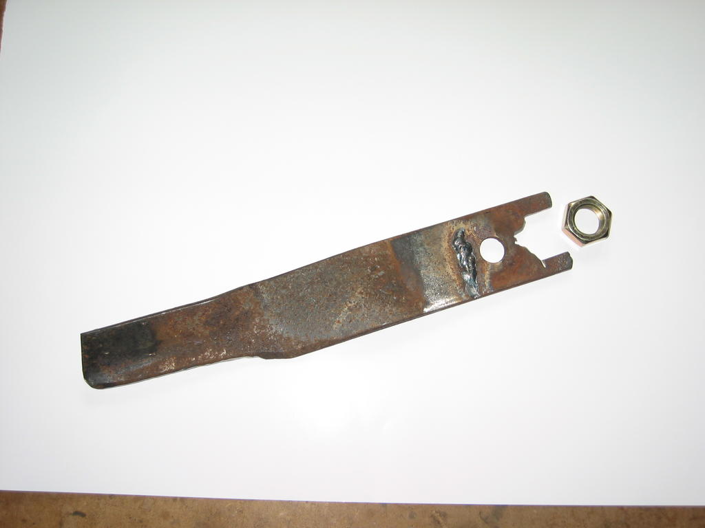

pfrederi 21,342 #26 Posted October 16, 2017 It is 1-1/8" You only need the thin wrench to hold above the blade. Any 1-1/8 socket/wrench will work on the nut. Make you own out of an old blade. Hacksaw and grinder..isn't pretty but it works and is free. 3 Share this post Link to post Share on other sites

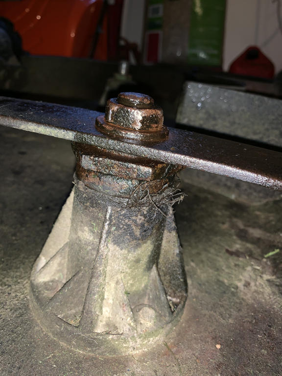

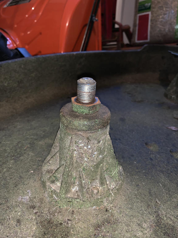

lzone3 0 #40 Posted May 2, 2019 Not sure if I missed something in this thread, but when I go to loosen the 1 1/8" nuts, with the blades all chocked/stabilized with wood/my hand, I can't crack the nut but I get the spindle to move, while the blade is still not moving. So picture me holding the blade with the socket/breaker bar around nut, and I finally get it to move, but its not the nut, its the spindle...how do i prevent the spindle from spinning so I can get leverage to break the nut?? I was able to get the middle nut free to remove middle blade. See pics, the middle spindle didn't have the extra "hex jam nut/spacer" is this vital or important to me getting the nut to break free?? I've sprayed the nuts with a penetrant, and used my porter cable 20V impact driver with socket adapter to no avail. Any help would be greatly appreciated. Share this post Link to post Share on other sites
953 nut 70,653 #41 Posted May 3, 2019 Best bet is to use a wrench to hold the spindle and a pneumatic impact wrench on the nut. 1 Share this post Link to post Share on other sites
WVHillbilly520H 10,379 #42 Posted May 3, 2019 6 hours ago, lzone3 said: Not sure if I missed something in this thread, but when I go to loosen the 1 1/8" nuts, with the blades all chocked/stabilized with wood/my hand, I can't crack the nut but I get the spindle to move, while the blade is still not moving. So picture me holding the blade with the socket/breaker bar around nut, and I finally get it to move, but its not the nut, its the spindle...how do i prevent the spindle from spinning so I can get leverage to break the nut?? I was able to get the middle nut free to remove middle blade. See pics, the middle spindle didn't have the extra "hex jam nut/spacer" is this vital or important to me getting the nut to break free?? I've sprayed the nuts with a penetrant, and used my porter cable 20V impact driver with socket adapter to no avail. Any help would be greatly appreciated. That much exposed spindle thread is not helping you out there, when installed correctly the nut should be flush to the spindle just barely protruding past the nut, those fine threads are taking a beating exposed to the scrapenel being spun around by the rotating blades...now if you don't have a a pnuematic impact wrench a 1-1/8" box end wrench and a rubber mallet/dead blow hammer can be substituted to break the nut loose so you can finish with your battery impact. 1 Share this post Link to post Share on other sites
Wes P 2 #43 Posted June 8, 2023 On 5/16/2012 at 8:01 PM, mrocket49 said: I'd love to get me one of these wrenches someday. the Craftsman wrench I use is a tight fit behind the blade. I found the wrench on e-Bay and ordered it! My Craftsman 1 1/8" wrench is too wide for the gap, I have a Wheel Horse 36" Rear Discharge Deck (0536MR03). Is there any alternative wrench until my Wheel Horse Wrench arrives? I thought about just buying a 1 1/8" wrench and grinding it down? Share this post Link to post Share on other sites
davem1111 2,453 #44 Posted June 8, 2023 4 minutes ago, Wes P said: I found the wrench on e-Bay and ordered it! My Craftsman 1 1/8" wrench is too wide for the gap, I have a Wheel Horse 36" Rear Discharge Deck (0536MR03). Is there any alternative wrench until my Wheel Horse Wrench arrives? I thought about just buying a 1 1/8" wrench and grinding it down? That's what I did. Got one at Rural King, I think it was about $12. Figured if it was a bit messed up from grinding it down, it was no big loss. Works great for me. I just picked up a 520-8 with a deck that looked like it had been sitting on the ground for years and the blades hadn't been off in quite a few more years. I also bought a larger socket and breaker bar - I think it might be a 3/4" drive and the bar is about 3/4" in diameter and about 20" long. If you get the wrench well seated and turn the spindle, the wrench will wedge against the deck. Then you've got lots of leverage. Some penetrating spray and sometimes some heat from a torch can help also. And like @WVHillbilly520H said, you don't want the threads sticking out to get beat up. The decks I'm familiar with have a thin washer behind the blade, and a thicker one in front against the nut. If you need to add another washer behind the nut or a thicker one, it will be worth it. Share this post Link to post Share on other sites

lynnmor 9,081 #46 Posted June 8, 2023 Don’t overwork your new Wheel Horse wrench, they are made out of peanut butter. 1 Share this post Link to post Share on other sites
Wes P 2 #47 Posted June 8, 2023 Interesting! How do you under-work your wrench when the Jam Nut requires 80-100 Ft-lbs of torque? Share this post Link to post Share on other sites
lynnmor 9,081 #48 Posted June 9, 2023 6 hours ago, Wes P said: Interesting! How do you under-work your wrench when the Jam Nut requires 80-100 Ft-lbs of torque? You buy wrenches made of quality steel. 1 Share this post Link to post Share on other sites
Wes P 2 #49 Posted June 9, 2023 So, your saying I need to re-temper this steel? Or, is the steel just trash? Share this post Link to post Share on other sites
lynnmor 9,081 #50 Posted June 9, 2023 10 hours ago, Wes P said: So, your saying I need to re-temper this steel? Or, is the steel just trash? In my opinion, the Wheel Horse wrench is something that you hang on the wall with the rest of your collectables, then use a real wrench to do the work. There is no way of knowing the type of steel, so just forget about doing any heat treatment. Share this post Link to post Share on other sites
