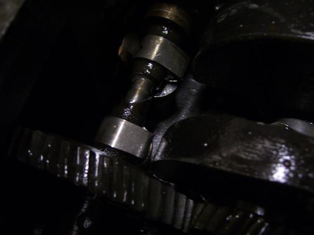

cjsdad 18 #1 Posted May 9, 2012 :banghead: I have had this C-85 for a few years now and used it mainly for plowing the snow in winter. At the end of the first winter while plowing the road the rod decided it was through playing nice and committed suicide. I put a new/used rod in it and put everything back together It ran great! Used it all year for some garden plowing, some ground leveling, driveway improvements and such. Then, this last winter while plowing the snow off the road the engine started knocking again. It sounded like the rod was chewing it's way out of the block! I parked it for a few months then tried starting it again a few weeks ago, The knock was noticable just turning the engine over and I imagined a loose rod cap or other such catastrophic problem but when I took the pan off the rod was fine! Started turning the crank by hand and CLANK! It isn't the rod! It is the camshaft! The camshaft is cracked at the base of the gear. As it turns past high lift on one of the valve lifters the cam jumps forward and the valve slams shut! That is the knock! I checked all the usual suspects and have only found two cams on the web. $60 on ebay! That seems a bit much since the crank can be found as low as $10. I suppose I will pay it if there are no other alternatives. Does anyone know if it is cast iron or cast steel? Can it be welded if it is steel? Just grasping at options here! :confusion-helpsos: Share this post Link to post Share on other sites

jay in nc 210 #6 Posted May 10, 2012 i just tore open a used k181 shortblock that i need to put in my commando 8 to go to the big show and i found the cam broken too. so the commando might not make it to Pa. on the bright side the member that sold me the short block refunded my money no questions asked! thanks bean. i took a picture. Jay Share this post Link to post Share on other sites
cjsdad 18 #7 Posted May 11, 2012 Here are a couple pics of the broken cam in mine. When it is lined up correctly the crack is hard to see. It is amazing the engine was even running with the amount of movement the camshaft has. The movement of the cam also damaged the advance weight return springs. You can see how much the arm of the advance weight has been hammered by the back and forth movement of the cam. Without that, the engine probably would not be running. Share this post Link to post Share on other sites
