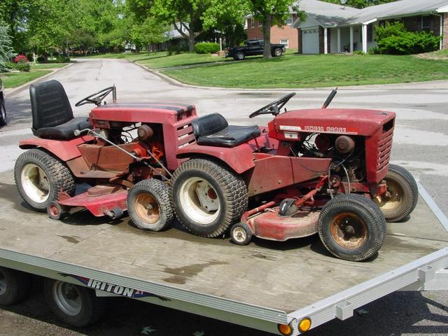

eibbed 63 #1 Posted May 7, 2012 Gentlemen, I purchased a Raider 10, snow plow and a Commando 8 last week. I have already sold the Raider 10m and am thinking about keeping the Commando 8. It reminds me of the 856 I have regretted selling a few years back. The original "Wheel Horse" 16x5.50-8 front tires on the Commando 8 are very dry cracked, and I want to replace them with 4.80/400-8 tires and rims that were removed from a Suburban 400. Unfortunately, the Commando 8 spindles are 3/4" shorter than the Suburban 400 rims. Can I replace the Commando 8 spindles with the Suburban 400 spindles? Thanks, Dave Share this post Link to post Share on other sites
Kelly 1,029 #2 Posted May 7, 2012 No the spindles will not work, but you can swap the tires from one set of rims to the other. Share this post Link to post Share on other sites
