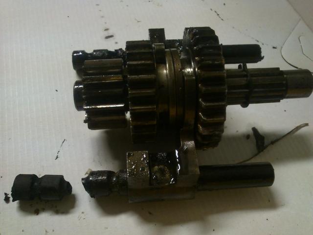

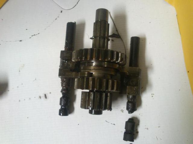

vikingex30 0 #1 Posted May 6, 2012 hello! i have a 10hp wheel horse with 3 gear + R. it says uni drive pat. no. 2988185. i need new seals and bearings and one of the gear fork has broken. it was stuck and broke when i took it appart. how to find new ones? Share this post Link to post Share on other sites

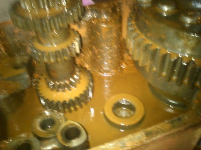

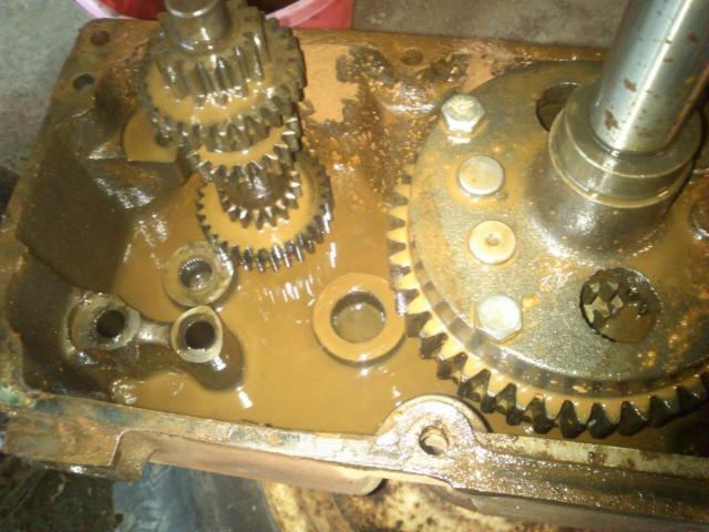

vikingex30 0 #10 Posted May 7, 2012 the tranny was full off water when i got it and 2-3 gear was stuck. Share this post Link to post Share on other sites

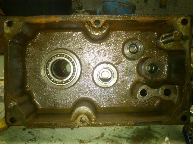

racinfool40 203 #11 Posted May 7, 2012 Ouch!!! I can say That's the 1st time I have seen that happen to a shifter fork....I have a few of them also.looks like your gonna need a 3/4 input shaft sel a 5/8 brake shaft seal and 2-1" axle seals..Hows the bearings look??? I have all the seals and shifter forks and I do Have some 1" axle needle bearings also..Let us know what all you think your gonna need. As far aa everything else give it a good cleaning and we caqn go from there. mike Share this post Link to post Share on other sites
vikingex30 0 #12 Posted May 7, 2012 some of the bearings are stuck so i shuld change all off them. sounds great! :) Share this post Link to post Share on other sites
Coadster32 793 #13 Posted May 7, 2012 Perhaps I'm mistaken, but I'm pretty sure the brake shaft is the same seal as the axle seals. (Might want to check b-4 ordering.) Good luck and welcome to RS. Share this post Link to post Share on other sites
vikingex30 0 #14 Posted May 7, 2012 i will. thanks :) Share this post Link to post Share on other sites
racinfool40 203 #15 Posted May 7, 2012 Yes. it depends on where your brake hub is mounted, I couldn't tell from your pics, If the brakes hud is mounted close to the axle tube then you will need another 1" seal..My Mistake I should have stated that before.. But in any case I do have them also.. MIKE Share this post Link to post Share on other sites
vikingex30 0 #16 Posted May 7, 2012 it is on the left side in front of the axle. you can se it on the pics. on the pics with the diff to the right and the gears to the left it is on the outside off the gears. Share this post Link to post Share on other sites

Anglo Traction 761 #18 Posted May 8, 2012 Look's like the Tranny could be a 4 speed Unidrive with Brake Shaft in similar position as an 8 speed. I think it could be a 3/4"dia (19mm) Seal/needle Bearing on the Brake Shaft? . Vernier Calipers anyone !. Good of you to offer your services Mike . Share this post Link to post Share on other sites
can whlvr 994 #19 Posted May 8, 2012 i think you are wise to replace all the bearings,maybe the big set ,the 1533 bearing might be salvageable,but do the rest while you are in there Share this post Link to post Share on other sites
