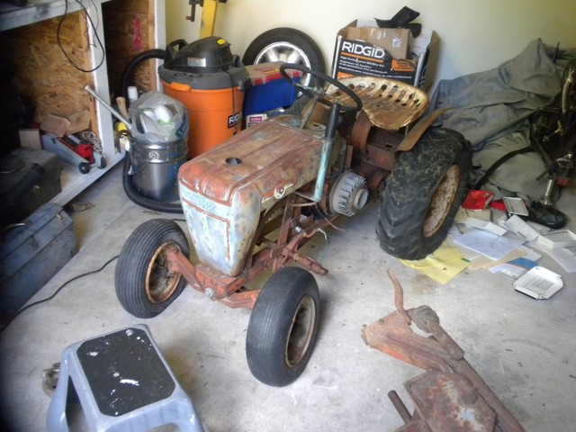

eightlitermopar 3 #1 Posted May 2, 2012 Hello all- I don’t know where to start with this wheel horse thing, so I figured this would be the best place. 2 Weeks ago I honestly had never heard of a wheel horse, now I have one. Attached is the picture of the wheel horse I acquired. There was a partial serial sticker but no numbers were on the remaining part. From what I have seen on the internet, I believe it to be a Suburban 550 or 551? I will give the short story. This tractor has sat for years as a project. Recently, the owner wanted to get it going, so a Harbor Freight engine was purchased just to get it moving. After some slight modification, the motor was in place. However, it was then discovered that the HF motor shaft turns counterclockwise; obviously the opposite direction needed to run the tractor. The plan was scrapped, and now I have the tractor. Anyway, I have a spare Tecumseh (part of anyway), and spare frame that came with the tractor. The engine turns over, but the original owner says it cannot be salvaged. I don’t really want to mess with it right now anyway. So now my questions: I would like to get this running as well. I like the idea of buying a complete engine, bolt on, and go. The frame appears to be originally set up for an electric start, but a pull start would be great for now. I respect the original aspect of this new hobby. I have been into cars for years and I wouldn’t put a ford engine in one of my dodge cars, for example. So an engine just to get it going would not be permanent. I just want something reliable that my and my young kids could drive around on it. So, what engines would work for this idea? Any suggestions would be helpful. I am very new to this hobby. Thanks! Share this post Link to post Share on other sites
jdog_kustoms 82 #2 Posted May 2, 2012 a pic of the other side would help tell what it is but it is a suburban 550 or 551 with wider rims front and rear looks to have potential thoe Share this post Link to post Share on other sites
neil 2,415 #3 Posted May 2, 2012 Welcome to redsquare , you picked the right place to get the information that you need . You have a great looking tractor and take my word for it it wont be your last wheelhorse tractor that you buy. With regards to the type of engine to put in , i would see if you could get hold of a Kohler K91 pull start . dont get an engine that will not fit under the hood otherwise you will end up having to cut things about to get the engine to fit , Im sure other here will also give you some real good advice Share this post Link to post Share on other sites
Coadster32 793 #4 Posted May 2, 2012 It's a 61 suburban alright, 551 looks like to me. Anything under a 5.5hp will fit under the hood w/o cutting it. (might need a short spark-plug). K91 is really nice, but you might be waiting a while to actually get one..especially with a recoil. I've had a 4hp briggs on a beater suburban and it worked just fine. Tecumseh fits good as well. This tractor actually calls for a Lauson h55 motor. (Good luck on that also). Nice score though. Share this post Link to post Share on other sites
Jake Kuhn 1,600 #5 Posted May 2, 2012 :text-goodpost: yep that is a 551 that calls for a 5.5 hp tecumseh lauson,unless you want to keep it original you may want to get a kohler k91. Nice find Jake Share this post Link to post Share on other sites

wallfish 20,220 #7 Posted May 2, 2012 :WRS: That HF engine should have been fine. The shaft turns CCW while looking straight on at that side of the engine and I think all small engines run that direction. There may be an exception to the rule somewhere. That's the correct direction of rotation needed to drive the transmission.The transmission will reverse the rotation to drive the tractor forward. All of a sudden, Utah is the hot bed for finding little round hoods. There's another new guy that just found a couple. 1 Share this post Link to post Share on other sites

eightlitermopar 3 #9 Posted May 2, 2012 That HF engine should have been fine. The shaft turns CCW while looking straight on at that side of the engine and I think all small engines run that direction. There may be an exception to the rule somewhere. That's the correct direction of rotation needed to drive the transmission.The transmission will reverse the rotation to drive the tractor forward. All of a sudden, Utah is the hot bed for finding little round hoods. There's another new guy that just found a couple. So I am learning something new here. The engine for this rig is SUPPOSED to turn counterclockwise? This is looking at it directly at the pulley side. Like my friend, I too thought that the crank rotation had to be the same direction as the wheels? Is this wrong? I'll post some more updated photos later! Thanks guys, I really appreciate your knowledge! eightlitermopar Share this post Link to post Share on other sites
stevasaurus 23,746 #10 Posted May 2, 2012 Welcome to Red Square...yes, the engine turns in the opposite direction from the wheels when going forward. Nice find BTW. Of course we want more pictures. :) :) Share this post Link to post Share on other sites
wallfish 20,220 #11 Posted May 2, 2012 In the Wheel Horse configuration, the crankshaft on the motor is turning in the opposite direction of forward travel of the tractor. CCW looking at the PTO pulley. You can turn the drive pulley on the trans by hand and shift through the gears and the axels will spin forward. Maybe it was in reverse when your friend checked it out. Share this post Link to post Share on other sites
horse700special 2 #12 Posted May 2, 2012 NICE FIND. My son has the same tractor as yours. The Lauson is awaiting a rebuild (probably a looooong wait). We put a HF 6.5 on it and it fits fine, bolts even lined up perfect. Only thing is the plastic air filter cover, the edge of the hood will ride on it. We added a couple washers to the bolt on the front of the hood for space. We also removed the shroud and painted it red. Share this post Link to post Share on other sites
Rooster 192 #13 Posted May 2, 2012 As most have told you , that had a Tecumseh/Lauson...the big advantage being that is was an electric start. You already have the HF engine, put it on there and get the thing moving! PLEASE DO NOT CUT THAT HOOD! You will regret it later! Share this post Link to post Share on other sites
