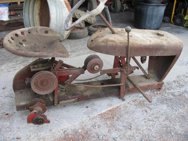

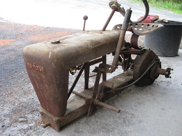

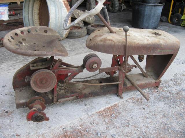

mdclem 12 #1 Posted May 1, 2012 OK. Need help figuring out what year and model this one is. I found it in the same building as the RJ-58 I am restoring (). Obviously the steering wheel is not original and it is missing a WHOLE LOT. 4 Share this post Link to post Share on other sites

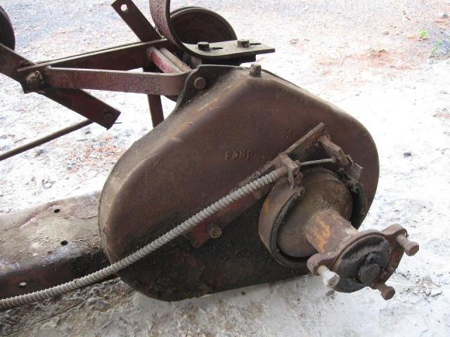

smokin joe 31 #2 Posted May 1, 2012 Thats a rj 35.My guess is its a 1957.And that brake setup is a rare option. Share this post Link to post Share on other sites

Jake Kuhn 1,601 #5 Posted May 1, 2012 Wow that is one good find! That is a 57 rj 35. jake Share this post Link to post Share on other sites

mdclem 12 #7 Posted May 1, 2012 Thats a rj 35.My guess is its a 1957.And that brake setup is a rare option. Smokin' Joe, don't know much, if anything about this tractor. What is rare/special about this brake setup? Share this post Link to post Share on other sites
TT-(Moderator) 1,188 #8 Posted May 1, 2012 It could very well be a later 1956 The brake option was actually pretty popular - once the owners found out there was no other way to stop the machine on anything but a level surface, many of these tractors were fitted with the foot brake kit. Share this post Link to post Share on other sites
smokin joe 31 #9 Posted May 1, 2012 Ive had a lot of rj 35's run through my shop.I've only ever had one that had the brake band and thats why I consider them rare... Share this post Link to post Share on other sites

VinsRJ 725 #13 Posted May 2, 2012 As always RJ35s are a very interesting item. Lets take a closer look at this one. First off its either a late 56 or early 57. Its got a sheet metal frame indicating a 56 but the embossed Wheel Horse hood indicating 57. Then its got 55 decals. Now the brake band on this unit was an add-on for sure and did not come with the tractor originally because... it doesn't have a machined wheel hub. You can make out the casted ridge on the hub and no machined brake surface. I would agree with the statement that the brake set ups are rare based on the fact if your RJ35 did not have one, you'd be hard pressed to find one or even the parts to put a kit together. Very nice score! 1 Share this post Link to post Share on other sites

rydogg 186 #16 Posted May 2, 2012 The front axle is very basic so it could be easily made, ebay has the cast iron reproduction steering wheel, drive axles, k90 kohlers are pretty common...you have a lot to start with already there I would put it back together. Share this post Link to post Share on other sites

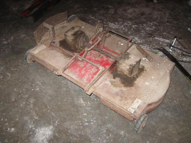

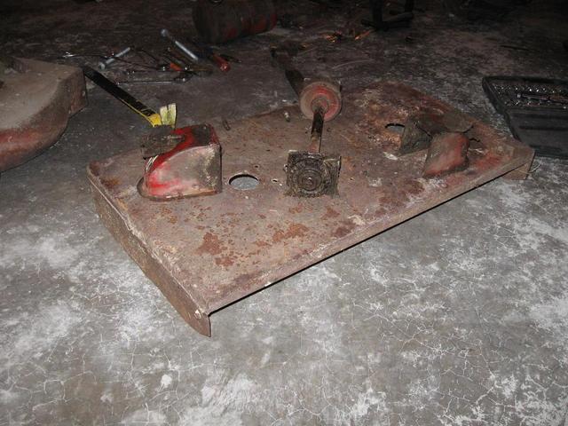

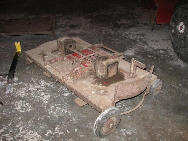

mdclem 12 #24 Posted May 3, 2012 Here are the two mower decks I retrieved also. Not sure which one goes with which tractor. Share this post Link to post Share on other sites
stevebo-(Moderator) 8,744 #25 Posted May 3, 2012 that tractor should have the square gear boxes but they are on a suburban deck ... i will post pictures of my 55 with mower deck in a few.. Share this post Link to post Share on other sites
