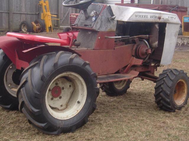

3609horse 27 #7 Posted April 28, 2012 I have the on an old c125 and they worked out ok, hopefully I got my pic to load. Gene 1 Share this post Link to post Share on other sites
neil 2,415 #8 Posted April 28, 2012 Gene, your c125 looks cool with the tool box and fenders , do you have a pic of the side view of that tractor Share this post Link to post Share on other sites

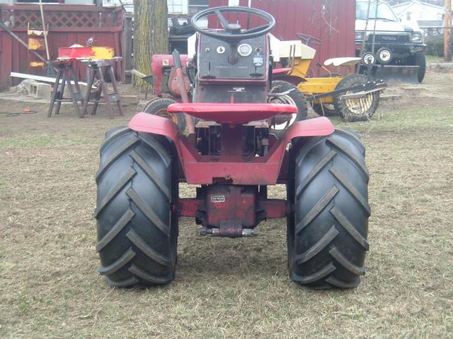

kpthorsefan 34 #9 Posted April 28, 2012 Here are the 23x10.50.12 tires i fitted to my C-141 and they went on a treat.. Share this post Link to post Share on other sites
AMC RULES 37,256 #10 Posted April 28, 2012 Gene, your c125 looks cool with the tool box and fenders , do you have a pic of the side view of that tractor What brand and size tire is pictured on the 125 Gene? :text-coolphotos: Share this post Link to post Share on other sites

3609horse 27 #12 Posted April 28, 2012 Here is one of the side view, I put a new hood on yesterday, this is my beast tractor, just getting around to getting it painted. Gene, your c125 looks cool with the tool box and fenders , do you have a pic of the side view of that tractor Gene, your c125 looks cool with the tool box and fenders , do you have a pic of the side view of that tractor What brand and size tire is pictured on the 125 Gene? I bought them at tractor supply, I paid too much for them, I found Cleavland tire has them 4ply I can get 2 for what I paid for 1 Share this post Link to post Share on other sites
