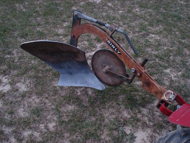

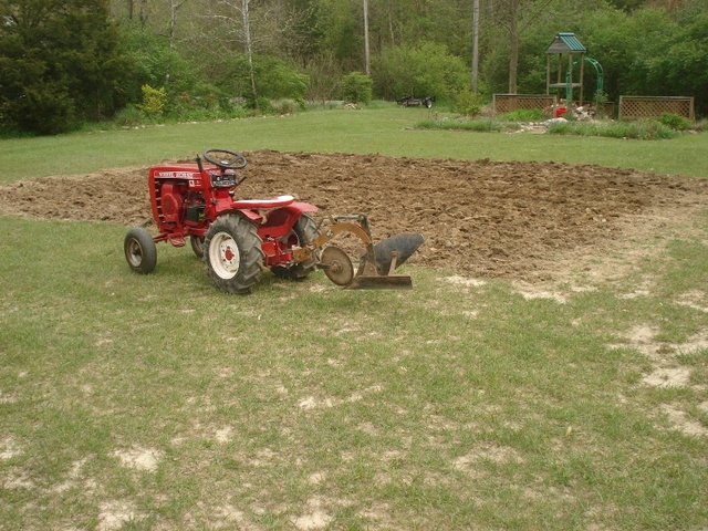

bean 85 #1 Posted April 25, 2012 started plowing the garden with the 73 8hp today. i tried it earlier this year and the 10" brinley plow was a little too much for the tractor. the ground has never been broken and is full of rocks and an occassional root. I decided to cut the plow down to 7.5". that has made all the difference in the world. it still bogs down a little when hitting rocks, but just powers on through. I have to disc later, but the robins were lining up to get at the earthworms. lots of fun and love to hear that old kohler getting 'er done. :) 2 Share this post Link to post Share on other sites

bean 85 #7 Posted April 25, 2012 I got a 10" for my Power King and figured it would be a bit much for the 704. I love the economy tractors. I think you are right about the 704. the 7.5" does a nice job and make a perfect furrow for the 6-12 lugs to ride in, so an 8" would work well. it also helps that I weigh 230lbs. thanks everyone for the nice words :text-thankyouyellow: Share this post Link to post Share on other sites

Wheel Horse Kid 105 #10 Posted April 26, 2012 Great setup there and nice 73 8hp! You can be surprised with what the smaller Wheel Horse tractors can do! Share this post Link to post Share on other sites
bean 85 #11 Posted April 26, 2012 You can be surprised with what the smaller Wheel Horse tractors can do! the 8hp kohler has a ton of torque. my grandson was surprised when he hooked up the WH our boat and moved it out of the yard. it is uphill and our old scotts 14hp hydro always had trouble. the 8hp moved it at half throttle without a strain. Share this post Link to post Share on other sites

wheelhorse 1045 3 #13 Posted April 27, 2012 nice look putting the tractor fenders on the 73, i always wanted to do that but never did Share this post Link to post Share on other sites

bean 85 #15 Posted April 27, 2012 nice look putting the tractor fenders on the 73, the boys and i picked out the things we liked about different wheel horse tractors. I wanted to keep it an 8hp kohler, and quick attatch and manual pto. they had a 854 and liked the look, so we put on the fenders/toolbox. the rear tires are off of an rj. the front tires are on 3.75" wheels fron a b-80. we are installing a 32" mower deck fron an rj. the only other thing I might add is an 8 speed from a '73 8hp-8speed. so, it is kind of a heinz 57 :) Share this post Link to post Share on other sites
