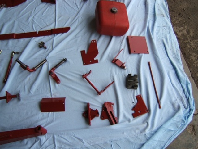

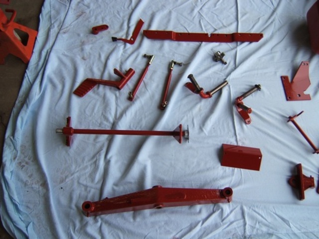

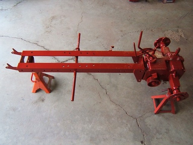

My winter project is finally starting to take shape . Just in time to cut grass up here !!
Had to make parts that were not availabe new. All bearings and bushings were replaced or fabricated
shifter boot has been replaced since tranny paint,dash is not done yet,sticker is on the way from Vinyl guy. will post more pics later

Looking good so far. Lot of little pieces to keep track of. Keep us posted on the progress. :thumbs:
Looks good. :thumbs: How much time have you invested to get to this point?

tractor is further along than shown in these pics. can only upload so much at a time !!
I definitely have over 70 hours so far (don't really want to know exactly how many).
More to follow soon.

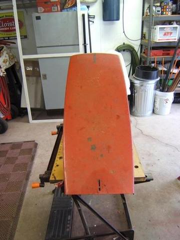

Where did the seat come from?

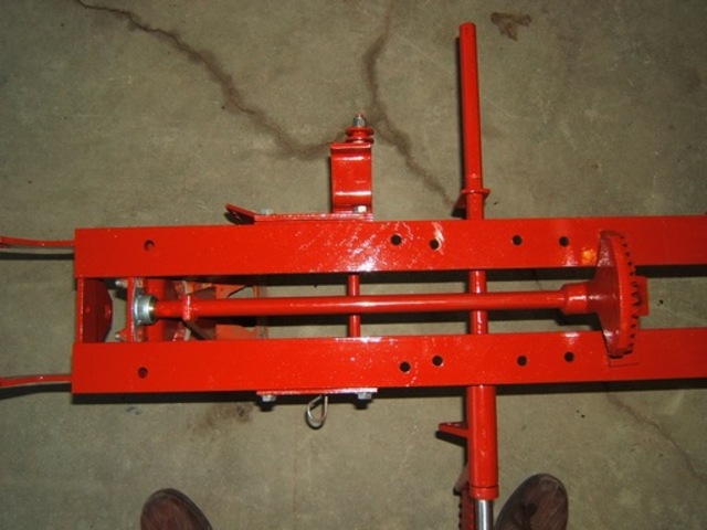

WH Raider10
Very nice restoration on your raider! Only you have to check your hubs as your axle is coming out of the hub! Make sure the end of axle is flush with the hub.

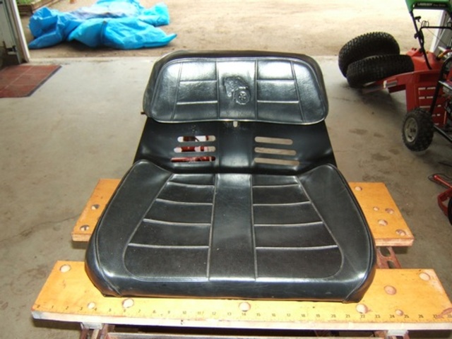

KATO
The seat is original, I disassembled it, welded up the cracks washed the foam, and re heat sealed it in plastic bags repainted it and glued the vinyl back on.
It has one seam coming apart(very minor) on the back of the back rest, i put some glue on it and left it alone. Thanks for the info on the hubs PJ i will fix that .
I was not aware they should be flush .
