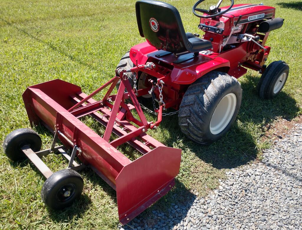

Kelly 1,039 #5 Posted April 25, 2012 I think Steve sells them to fit the C's, 300, 400 and 500, but I think only the hydros, check with him, the guy that posted the pic of the 520 with one. Share this post Link to post Share on other sites
stevebo-(Moderator) 8,744 #6 Posted April 25, 2012 As Kelly said I do have one I posted in the picture above. I tried to sell them but the lack of interest in the hitches made me decide not to make any more. My point in posting the picture is to show you that it can be done and I am sure the C175 is more than strong enough to lift any category 0 tool. Share this post Link to post Share on other sites

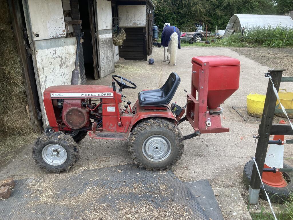

Wheel horse_c101 0 #14 Posted November 1, 2024 would this work with a c101 Share this post Link to post Share on other sites
kpinnc 19,107 #15 Posted November 1, 2024 (edited) 7 minutes ago, Wheel horse_c101 said: would this work with a c101 This is a really old thread, but I’ll take a stab at it. Yes- you can build a 3-point system onto any Wheel Horse. That being said, it becomes more difficult when the fuel tank is under the seat as with a C-101. Also, it’s most helpful when your machine already has hydraulic lift. I don’t recall the C-101 having that. But like any project, it’s up to how much time and money you want to put into it. You always have options. Personally I’ll not likely build another one. It took a great deal of fabrication to make it work. Couple that with the actual benefit on a 500lb machine, and you begin to see the limitations. If I ever build another, it will work off the manual lift because it it’s too heavy to lift by hand the tractor will struggle with it anyway. Mine will easily lift 300lbs or more, but will fight to pull the weight when dug deep into the ground or steer well. Don’t misunderstand, I love my Bronco 3-point! But even Category 0 implements are a bit oversized for a tractor of this size. Edited November 1, 2024 by kpinnc 1 Share this post Link to post Share on other sites

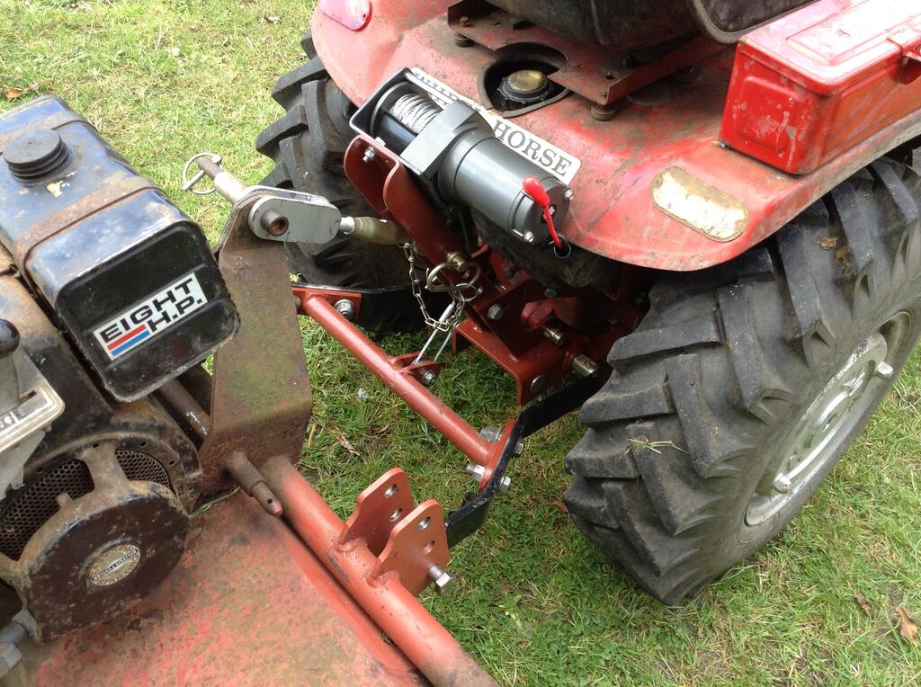

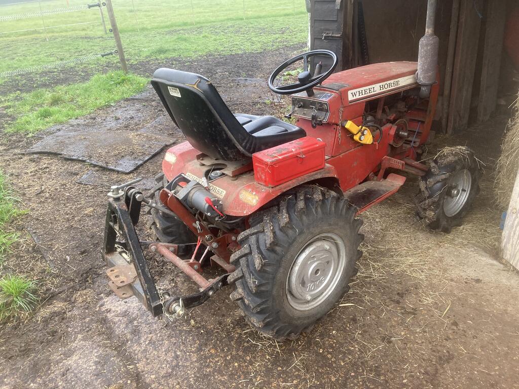

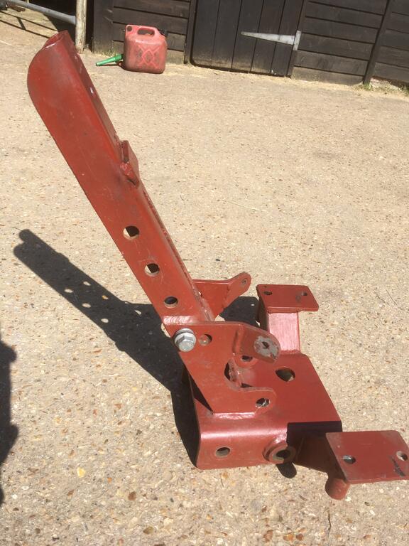

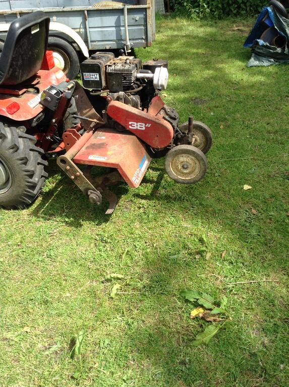

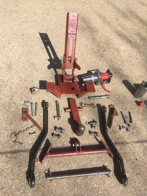

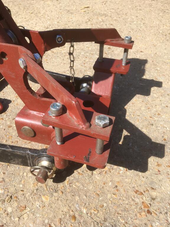

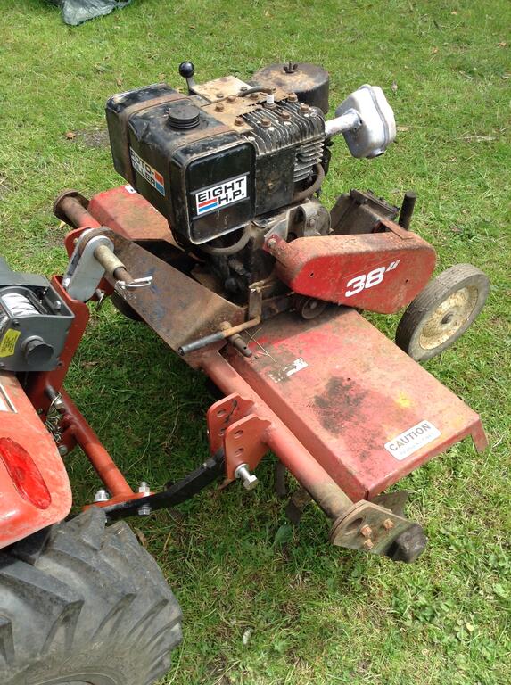

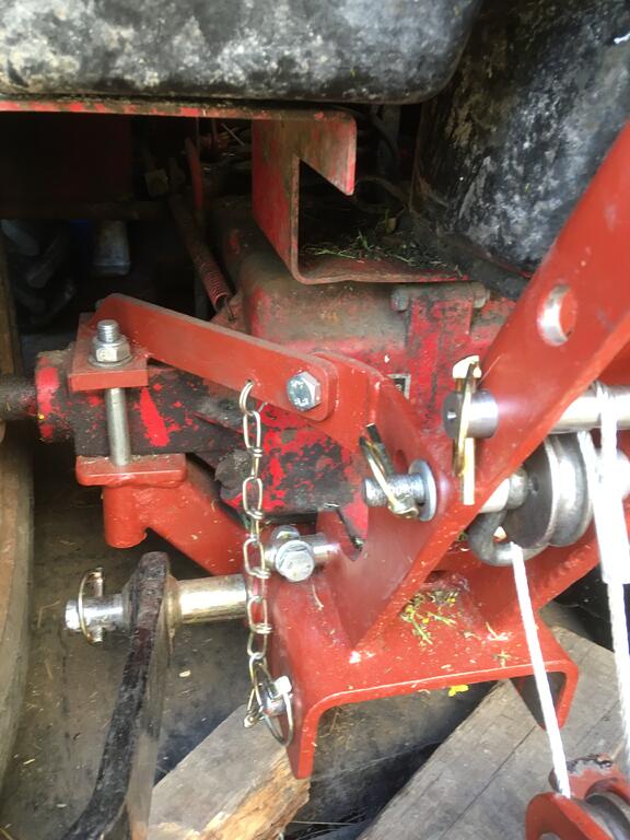

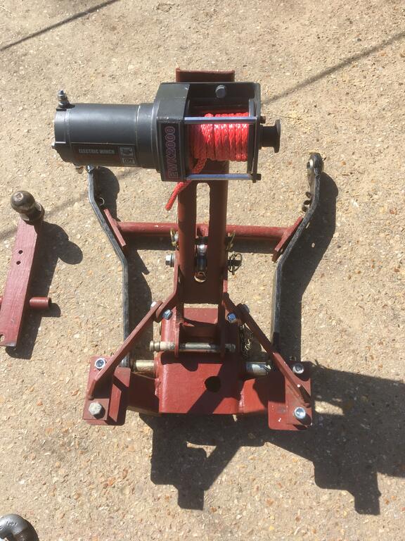

ranger 1,871 #16 Posted November 2, 2024 (edited) 17 hours ago, Wheel horse_c101 said: would this work with a c101 Here are a few pics of mine on a C121. Winch powered not hydraulic. Only 4 bolts and 1 pin attach it to the tractor, (along with the wiring), so I can transfer it to any of my other Wheelhorses! Edited November 2, 2024 by ranger 2 3 Share this post Link to post Share on other sites
953 nut 70,651 #17 Posted November 2, 2024 More than one way to get it done. 1 Share this post Link to post Share on other sites
