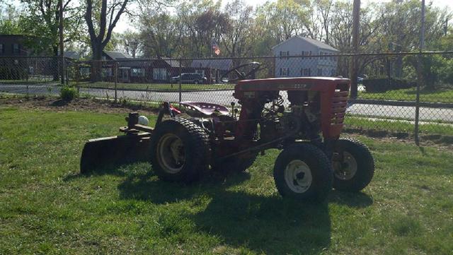

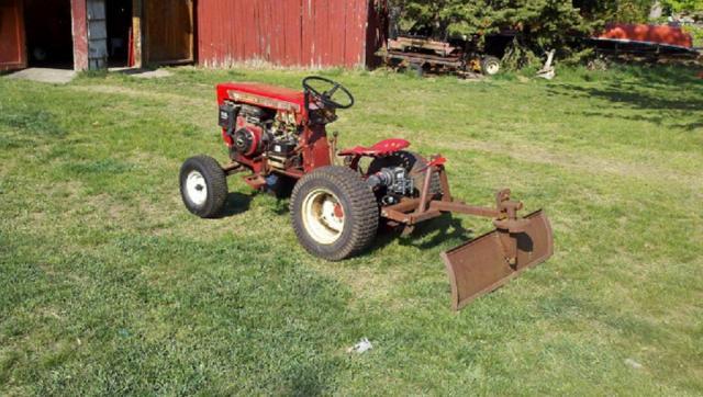

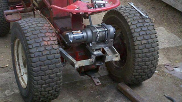

kris22 6 #1 Posted April 22, 2012 So im new to the site, never posted before now just used it for information and ideas. Years ago in high school welding class I made a cat 0 three point rear blade from a set of plans from my stop teacher tractor magazine. My old bolens didn't have a three point hitch so I made a 2" receiver and an adaptor for it to pivot off the bottom and I would lift it by the lift cable attached to the top link mount. Anyways I blew the motor in the old girl and been wanting to put the plow on a horse so today I made a mount for my charger 9 (it has a 6.5hp briggs on it. I know I know a horse with a briggs, in my opinion its still better than the finiky tec that sadly came on it. And again I know a 6.5 believe it or not it doesn't seem to struggle at all with the 8sp that I swapped into it) that resembles the class 3 hitch on ebay but with my own twist. I had purchased a 3000lb. winch from HF and welded up a bracket to be able to lift the plow with or get me out of a dumb decision. Plow pivots on both x and y axis which makes it very convenient for odd grades and can spin a full 180° so I can push or pull it. Basicly I just want to see what you guys think of it. Share this post Link to post Share on other sites

kris22 6 #3 Posted April 22, 2012 here are some pics 4 Share this post Link to post Share on other sites
varosd 1,185 #4 Posted April 22, 2012 Wow, looks great how is it working out? are you using out on loose dirt or gravel? and :WRS: Share this post Link to post Share on other sites
AMC RULES 37,220 #5 Posted April 22, 2012 :WRS: Looks like it should work pretty good Kris, have you tried it out yet ? Share this post Link to post Share on other sites
Hydro 131 #6 Posted April 22, 2012 Looks like a real nice set up Do you need any weight up front? Share this post Link to post Share on other sites

KC9KAS 4,744 #9 Posted April 22, 2012 Welcome to RS, and very nice grader blade. Does the winch cable just connect to the area of the 3 pt hitch where the top link would connect? Share this post Link to post Share on other sites
kris22 6 #10 Posted April 22, 2012 Wow, looks great how is it working out? are you using out on loose dirt or gravel? and in the past ive used it on loose dirt, stone dust, mulch, snow, came in handy for spreading the 2yds of stone dust my grandfather got for redoing his driveway. as soon as it was done i played around in some old grass compost we had pushed up agaist a fence but other than that i havent used it yet Looks like a real nice set up Do you need any weight up front? i absolutly need weight in the front even without the plow the front end comes off the ground if im not careful letting out the clutch but i dont know what im gonna make yet, kinda want to avoid wheel weights mainly because i have a set of ags i am debating on putting on it, any ideas on homemade weights would be appreciated. Welcome to RS, and very nice grader blade. Does the winch cable just connect to the area of the 3 pt hitch where the top link would connect? ya the winch cable goes to the top link as of now, when it was on my bolens i had an actual top link on it so i could have down pressure but it was real slow going raising and lowering it. not even 12hrs later and i want to build a scarifier of sorts that will attach to the bottom of the plow so i can rip up untouched ground. i wanna bring it to the show in somers, ct. may 19th. will probably get alot of ugly looks from the purists having swapped motor and trans and whatnot but any attention is good attention in my book Share this post Link to post Share on other sites
