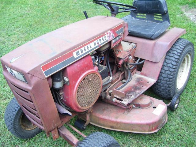

jay in nc 211 #1 Posted April 16, 2012 so last april i bought a 72 bronco 14 off e-bay, turns out the seller was member kj4kicks , eldon a super nice guy & one of our vendors on the square. well he delivered it to the big show in june & i picked it up there so i had a horse to ride there. i brought it home & didnt have time to mess with it much. so with the meet & greet comming up in 2 weeks april 28 i want to get more horses going. well it needed a front tire so i dismounted it wire wheeled all the rust & paint off the wheel then primed & painted it. next i mounted a used tire & tube & put it back on the bronco. next was an oil change & a new battery, full tank of gas with seafoam in it. BOY DOES IT RUN GREAT ! well i put it on the lawn, made a lap & the deck fell off , so i get it back on & put a pin in the tatch a matic so it won't hapen again. well it dosn't cut at all, so back to the shop ,jack it up & look at the blades there on upside down so they were trying to cut with the back side, fliped them & went back on the lawn & i cut for 15 min. it's better but not great , yery littile coming out the side discharge. so back to the shop, take the blades off again & i figgured out that they were for a left hand discharge deck like my A.C. B10. well i had a deck that was totaly rusted out but had good blades on it so i sharpened them up & installed them and mowed 2 tanks of gas through it ! it mowed great but the small rusr hole in the r. r. corner will need repaired soon. when i put it away i checked the oil & it didnt use a drop. thanks eldon for selling me a good tractor. Jay Share this post Link to post Share on other sites
jay in nc 211 #2 Posted April 16, 2012 sorry heres a picture of the bronco. B.T.W. i love not having to go to photo bucket! Jay Share this post Link to post Share on other sites

kpinnc 19,053 #5 Posted April 16, 2012 I've seen that tractor before... Eldon was thinning the herd a bit, and sold quite a few of them. I wish the budget would have allowed me to buy a few of them myself! I'm a big fan of Broncos Jay, glad to see another one put back in service. See you on the 28th! Share this post Link to post Share on other sites
Kingwood990 16 #6 Posted April 16, 2012 Looks like a keeper to me Jay. Can I test drive this one on the 28th? Share this post Link to post Share on other sites

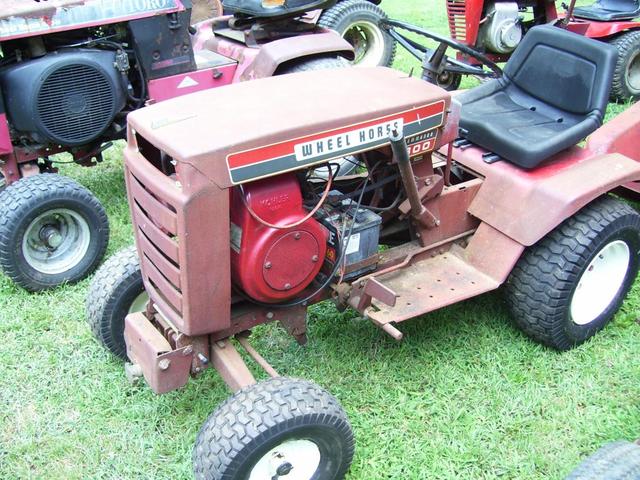

jay in nc 211 #10 Posted April 17, 2012 van, i just got the engine & drive pully installed tonight , fuel filter & hooking up the throtle & choke cables + about 10 min. work to do on the belt guard & ill wrap the rope give a pull & take her for a ride! working 12 hours this week so it may or may not happen, but i got the fever! 1077 now 1277 tecky will ride again! Jay Share this post Link to post Share on other sites
Terry M-(Moderator) 2,329 #11 Posted April 17, 2012 Looks nice! I always liked that style WH :text-coolphotos: Share this post Link to post Share on other sites
Wheel-N-It 2,978 #12 Posted April 17, 2012 Thats great news Jay. Boy am I excited to see that one. Appx what year was that Techy manufactured? Share this post Link to post Share on other sites
jay in nc 211 #13 Posted April 18, 2012 i dont know when it was made , it's a nos hh 120, got it to fire on carb cleaner tonight but the float bowl gasket come off in 20 pieces, and the pull rope was so dryrottedit broke twice. i will try again tomorow. i see a starter-generator set up in it's future. did W.H. ever offer one for a tecky? Jay Share this post Link to post Share on other sites
