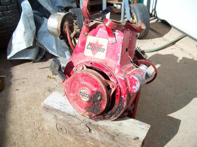

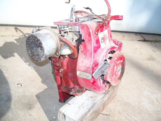

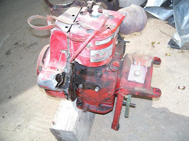

Kelly 1,033 #1 Posted April 11, 2012 I picked up a little Clinton today, I think it's the newer version of the one used on the RJs but not sure, this one had elect. start and looks to have a charging stator on it, the starter is gone and they took it off with out caring about anything, messed up the blower housing, the model no's are 498 5301 281 I havn't messed with it yet wife says it's supper time, I'll see if I can get it started later. Share this post Link to post Share on other sites

Kelly 1,033 #3 Posted April 11, 2012 Well after changing the broken plug, topping the oil off, it sat upside down, removed the blower housing, wrapped a rope around the drive for the recoil, and giving it a pull, it had spark, so I shot a bit of brake clean in it and it fired up, then I hooked up my starter gas tank I use to run engines, and it runs pretty darn good no smoke even the carb works nice, idles very good throttles up nice, I need to pull the mount and pulley off it from the tiller it was on, to see what size crank it has, it will make someone a good RJ engine, you could if you get a starter have elect. start with a charging system. Look for it soon in the classifieds. Share this post Link to post Share on other sites
buckrancher 2,695 #4 Posted April 12, 2012 crankshaft should be 3/4" Share this post Link to post Share on other sites
