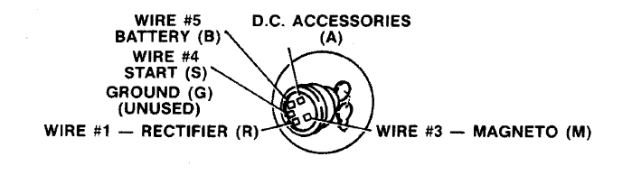

liketoplayto 6 #1 Posted April 10, 2012 ok i have a gt 18 but someone i believed replaced the ignition switch with a 6 prong switch i dont think thats right does someone know which switch i need cause i got it to start but cant get it to shut off thanks wes Share this post Link to post Share on other sites
rmaynard 17,494 #2 Posted April 10, 2012 Just to be certain, what is the correct ID on your GT? The part number listed for GT-1800, 1848 is 103991. Share this post Link to post Share on other sites
rmaynard 17,494 #4 Posted April 10, 2012 That's your switch. Share this post Link to post Share on other sites
