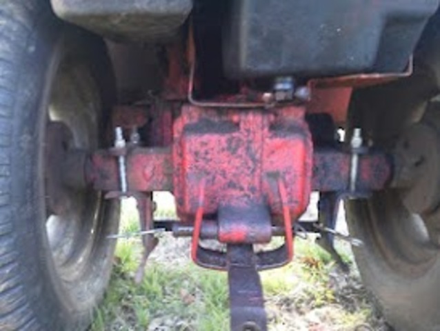

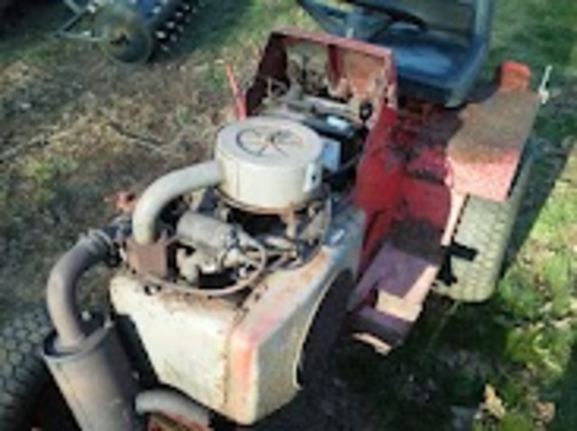

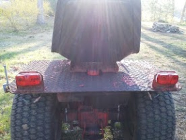

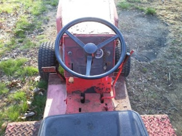

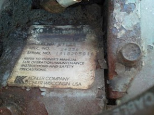

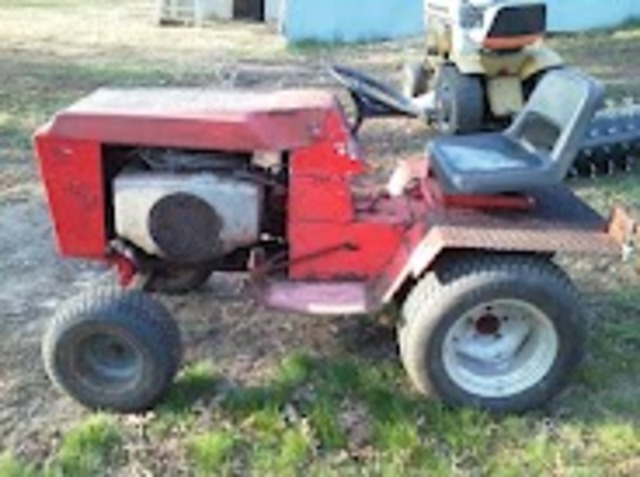

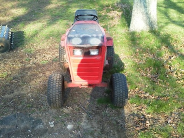

sorry for the confusion so does anyone know what the drive belt size ispost-6782-0-03014100-1334067185.jpgpost-6782-0-50349700-1334067185.jpgpost-6782-0-90465700-1334067185.jpgpost-6782-0-36084300-1334067186.jpgpost-6782-0-73717000-1334067186.jpgpost-6782-0-08356800-1334067187.jpgpost-6782-0-49124000-1334067187.jpgpost-6782-0-92616000-1334067187.jpg
WH854
Try Belt P/N 93-9809( 5/8" X 83" or P/N 7473 (5/8" X 82") Toro Part Numbers :thumbs:

You have a Series 2 KT 17 it is a sound motor.
ushoundog
this bad boy idles down to about 80 rpms
any tips i should use to get it restored
can whlvr
one is to take ALOT of pictures,if you are gonna tear it down,they become your bible when you put her back together,take as many as you can,like throttle linkage,cable routing,wiring,the more the better

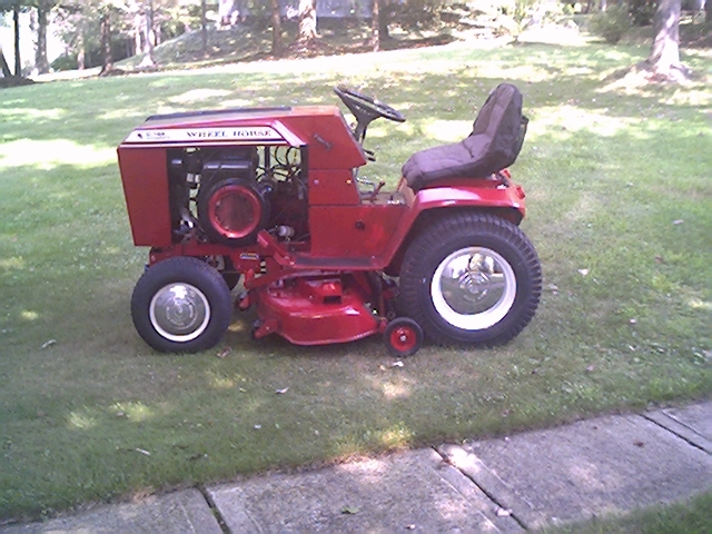

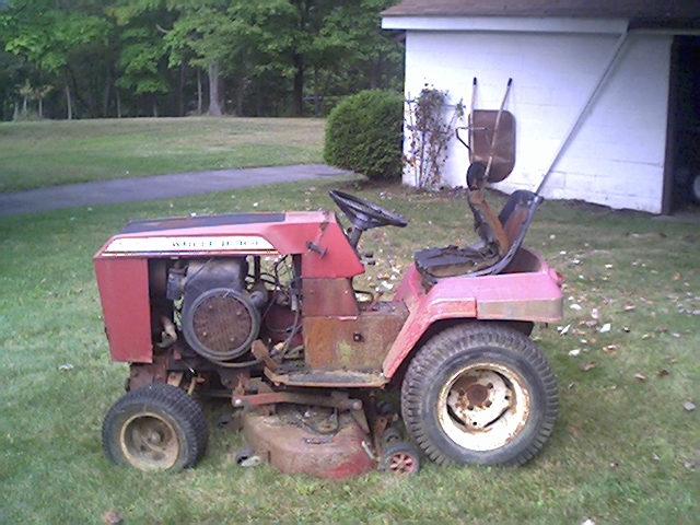

:text-yeahthat: Here is one I started withpost-489-0-50267800-1334075905.jpg
What it looked like later
You have to have a lot of patience :thumbs:

Series 2 are good motors but they are not designed to idle that slow. You will not have her long running that slow. Cooling an oil flow will be to small...SM for Kohler KTs specs idle speed at 1200 rpm +/- 75
