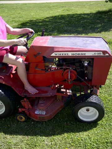

brandonozz 168 #1 Posted April 9, 2012 Hello all! I would like to share a few pics with the group and ask a question about a problem with a "off brand". I use my two horses for gardening and building food plots. The first pic is a pasture area I cleared for a food plot using a C120-8 with a 36" RD deck. I was able to knock down the vegitation much faster than I thought I would be able to as you can see it is quite high. Really never bogged down the 12 hp Kohler. Here is a pic of my recent find - a C165-8 in semi restored condition. I was looking for a snow blade and the PO had one and when I went to get the blade he offered the tractor as well. Blade has surface rust pretty bad but is in great working condition. Package deal for the blade and tractor was $300 - couldn't pass it up. Now a question about my hydro mower I use on the lawn. This Simplicity has a Kohler Command 16 hp engine. I got back after a trip (unfortunately the wife mowed while I was gone and never noticed anything - she never does!) and went to start the mower to mow again. After starting I removed the choke and lowered the throttle and the engine reved so high I thought it would fly apart. I turned the key off to kill it and check it out - everything with the linkage seemed OK so I restarted and the engine did the same thing. To make a long story short - after looking for the problem a while I found that the two screws that hold on the butterfly plate had fell out and the throttle was wide open. Removed the carb and fished out the plate at the intake valve. Now to my question - what kind of damage should I expect from the screws going into the engine? The screws were nowhere to be found and I would expect them to be inside the engine. Anyone ever experienced this before? Thanks for the help. Share this post Link to post Share on other sites
