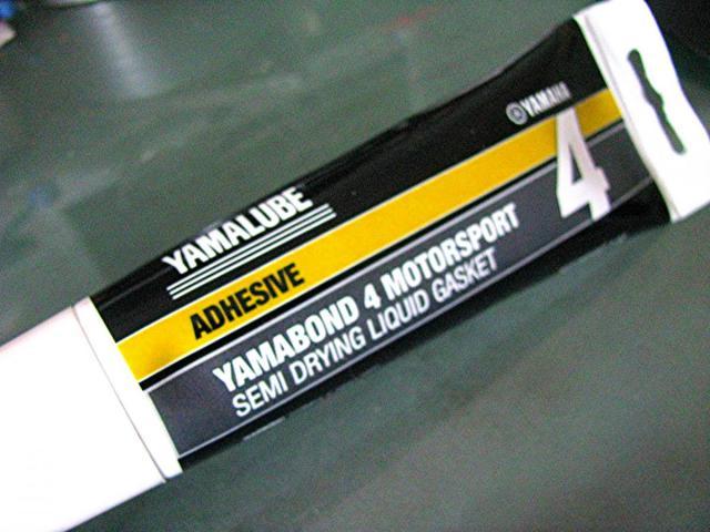

AMC RULES 37,256 #4 Posted April 8, 2012 Yep find another, not worth the aggro bro...but then again...if you were determined to try, and get creative...this stuff just might give you the best results. :dunno: Share this post Link to post Share on other sites
